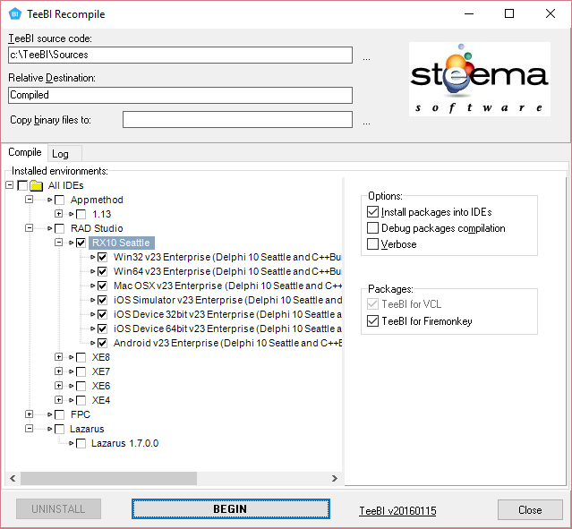

TeeBI includes an automatic installation tool "TeeBIRecompile.exe".
This tool automatically recompiles all packages and sources for each selected ide.
After compiling, it registers the packages so when you open the IDE all TeeBI components are ready to use.

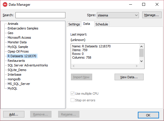

Inside the IDE, the menu "TeeBI -> Data Manager" shows the Data Manager dialog where you can manage Stores and import data into them.

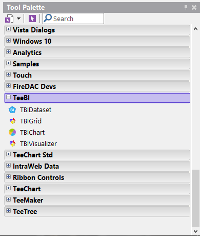

The IDE component palette includes a TeeBI category, for both VCL and Firemonkey frameworks.

The recompile tool automatically determines which TeeChart version, if any, is installed at each IDE.
If the TeeChart version is "Lite" (the one that comes included by default), it will recompile TeeBI packages using only the Lite features.
