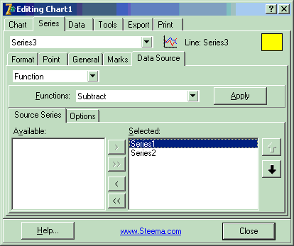

When you have added the function go to the DataSource tab of the Series page. Here you may choose which input Series (or Series) to add to the function. The first Series in the selected listbox, reading from top to bottom, is the Series on which the operation is performed in the case of function which doesn’t treat each member of the list homogeneously.
Eg. Subtract.
Width1Width3Width1418Width3Width5883Fig. 1.
Subtract function defined in the Chart editor |
![]() Width1Width3Width1418Width3Width5883 |
In the Chart editor screen you see Series3 being defined with inputs Series1 and Series2. The Series order in the list defines which Series is doing the subtraction.
Here:Series3:= Series1 - Series2
