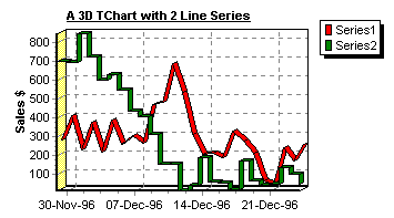

3D Line Series showing one Series with the stairs property set to true. The stairs can be inverted.
