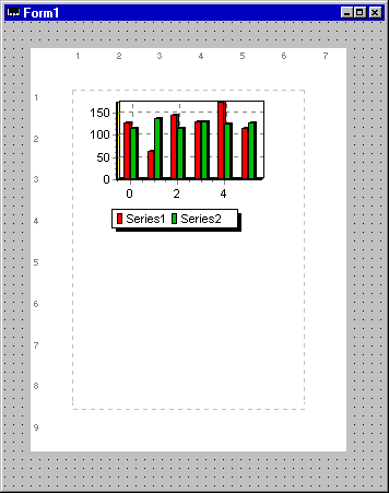

TeeChart integrates seamlessly with Qusoft’s QuickReport. To add a TeeChart to a QuickReport follow these steps:
Drop a QuickReport on a form.
Using the QRChart icon on the QuickReport palette
Put a TQRChart onto the QuickReport worksheet.
You may now double click on the TQRChart to bring up the Chart editor. From this point forward you may work with the Chart as with any other TDBChart.
At runtime, access properties and methods for the Chart via the TQRChart.Chart property.
TQRChart on a QReport at design time
