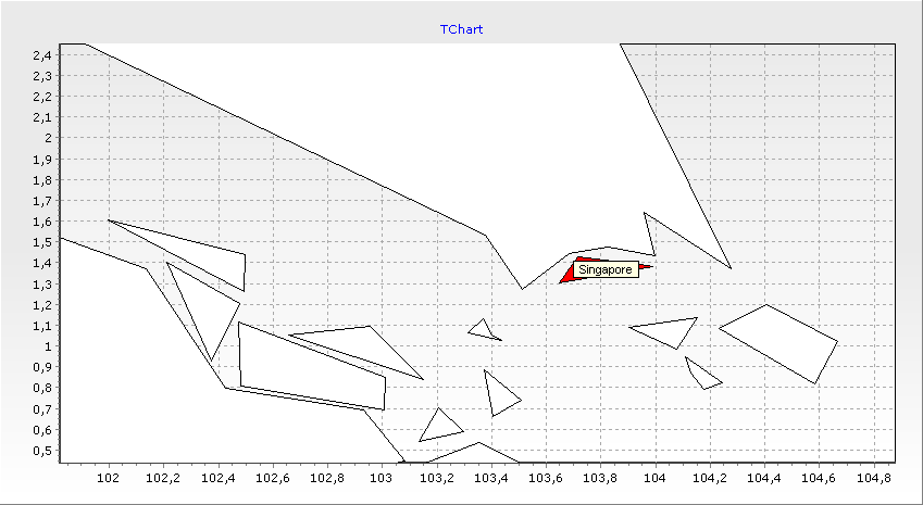

Well, it's not an island but in TeeChart it looks like one... :oops:
Here it is in Google Maps:
And here it is with the following code in TeeChart:
uses TeeWorldSeries;
var Series1: TWorldSeries;
var i: Integer;
  Chart1.View3D:=false;
  Chart1.Legend.Visible:=false;
  Series1:=Chart1.AddSeries(TWorldSeries) as TWorldSeries;
  Series1.Map := wmWorld;
  Series1[1839].Text:='Singapore';
  Series1[1839].Color:=clRed;
  Series1.Marks.Visible:=true;
  Series1.OnGetMarkText:=Series1GetMarkText;
procedure TForm1.Series1GetMarkText(Sender: TChartSeries; ValueIndex: Integer; var MarkText: String);
  if Series1[ValueIndex].Text <> 'Singapore' then
    MarkText:='';
AccessCoder wrote:Also, it doesn't appear on the Asia map either and that is where it would be the most useful. How do I go about adding a polygon for Singapore?
You're right, it only appears in the World map and should also appear in the Asia map. I've added it to the defect list to be implemented in future releases (TV52015380).

My may doesn't look nearly as nice as yours when I use TCommander to zoom in:
What am I doing wrong? Also I still can't identify Singapore on my map. Here is the code I am using to turn on some colors. Malaysia and Indonesia show up but Singapore doesn't:
I could reproduce your problem here and I have added your request in bug list report with number [TV52015383]. We will try to fix it for next maintenance releases of TeeChartVCL.
