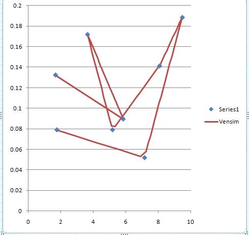

I tried that. What I'm trying to show is a kind of flight plan, similar to the attached image.
- ExcelSample.jpg (47.28 KiB) Viewed 9677 times

In that case you should use line series with visible pointers and set XValues.Order to none before populating values. By default it's set to ascending.

Got it working now. Many thanks. I just needed to set the order to none on both X and Y.
Tony.
TChart1.Series(1).YValues.Order = loNone
TChart1.Series(1).XValues.Order = loNone
