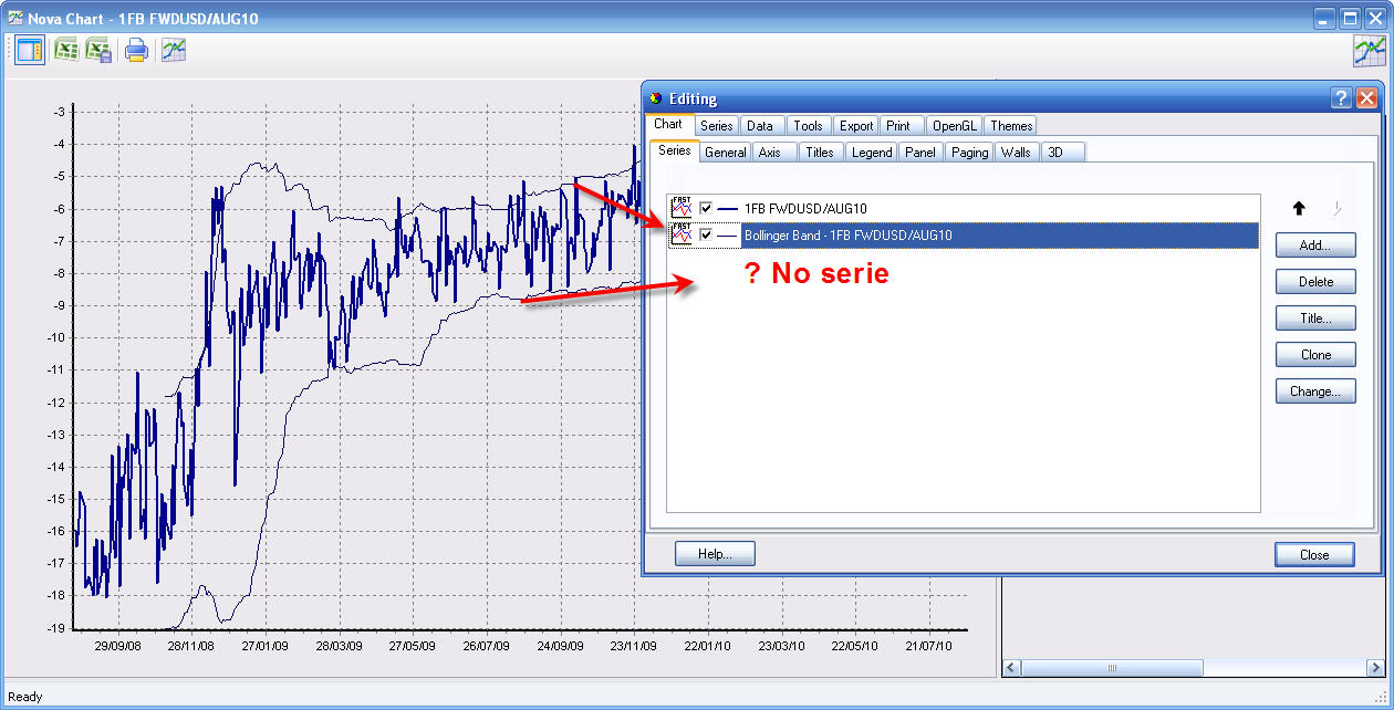

When I used Bollinger function, only 1 serie is added in TeeChart Editor but 2 series are displayed in Chart Control
I would like to have 2 series added in my Teechart editor when I use Bollinger function (1 for upper band and 1 for lower band)...How can I do that ?

I've added your request to the wish list to be implemented in future releases (TV52015105).
Right now, it can be done if you know the index of the internal series:
uses StatChar, Series;
var Series1: TFastLineSeries;
    Series2: TFastLineSeries;
    TeeFunction1: TBollingerFunction;
  Chart1.View3D:=false;
  Series1:=Chart1.AddSeries(TFastLineSeries) as TFastLineSeries;
  Series1.Pen.Width:=2;
  Series1.FillSampleValues(100);
  Series2:=Chart1.AddSeries(TFastLineSeries) as TFastLineSeries;
  TeeFunction1:=TBollingerFunction.Create(self);
  Series2.FunctionType:=TeeFunction1;
  Series2.DataSource:=Series1;
  Chart1[Chart1.SeriesCount-1].ShowInEditor:=true;
  Chart1[Chart1.SeriesCount-1].ShowInLegend:=true;

You're right - the ShowInEditor method solve this issue...waiting the next release :D
