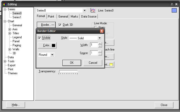

I have a line series, when I view the editor, and click series, there is a button for "Border".
How do I access those settings for the border via code? I cannot figure it out. I assumed it would be something like
series.GetAsLine().GetBorderPen()
but I just cannot find out how to access the border settings.

No, that's the line colour itself. I mean the border properties of the line (see attached image).
Also, below the border popup in the attachment there is a setting "Height 3d". I cannot find how to set that in code either.

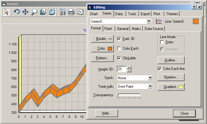

What TeeChart version are you using? Here is my result in VB6 with TeeChart AX 8.0.0.8 and also with the TeeChart AX v2010 beta.
Private Sub Form_Load()
  TeeCommander1.ChartLink = TChart1.ChartLink
  TChart1.AddSeries scLine
  TChart1.Series(0).FillSampleValues
  TChart1.Series(0).Color = RGB(255, 128, 0)
  TChart1.Series(0).asLine.LinePen.Color = vbGrayText
  TChart1.Series(0).asLine.LinePen.Width = 3
  TChart1.Series(0).asLine.LineHeight = 20
