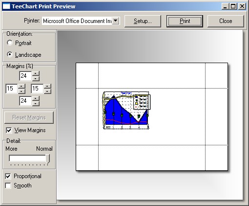

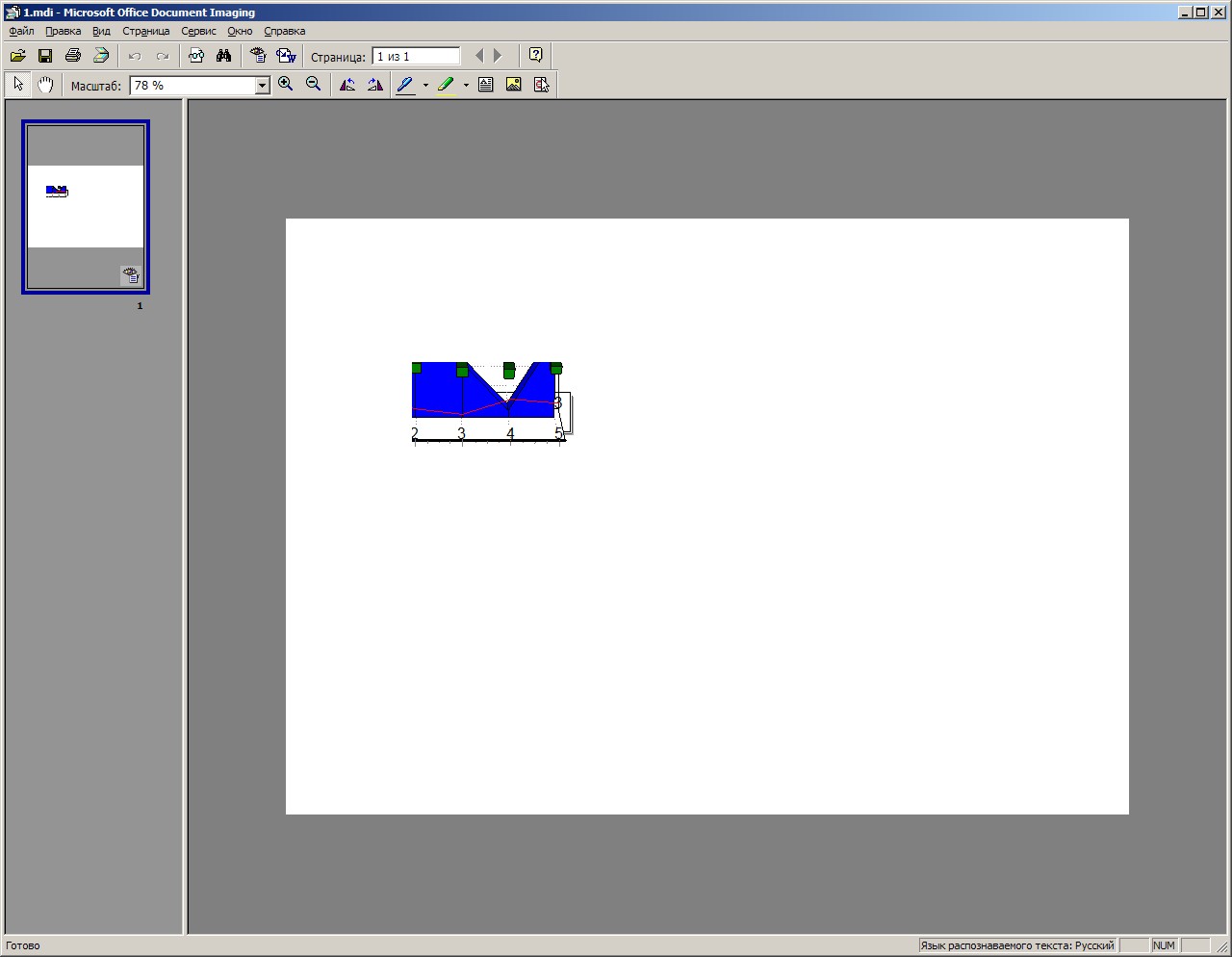

As you can see from attached screenshots, everything looks OK on the print preview page, but the actual print result is incorrect.

The actual print result (shown in Microsoft Office Document Imaging)
Print preview

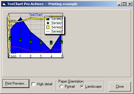

Modified "Printing" example
