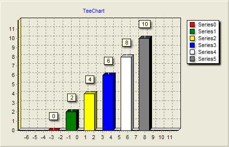

Can someone try the VB code below?
The first bar has a X value of "0", but appears on the plot at approximately -3. What is going on?

Hi Tony,
I'm afraid this is a bug I have added to the defect list (TV52015189) to be fixed.

Thinking a little bit further about this issue, the stacking algorithm will work correctly *only* if all series have the same number of points and point x values coincide. If this is not the case, you'll have to use AddNullXY method to add "missing points". I'd use the following approach:
1) Make a list of all available (pool) of x values.
2) For individual series, cycle through (1) and use AddXY if point (x,y) exists and AddNullXY if specific point (x,y) does not exist for this series.
An easier alternative is setting MultiBar to mbNone, for example:

This is how stacked series are designed. For stacking to work you need to have same number of points in all series and all of them should have same X values. Setting Multibar to mbNone doesn't label series wrongly but it may be nicer in 2D. There are 2 options here:
1. Set MultiBar to none and the chart to 2D view:

My original query is not related to stacking in any way. It's basic code to draw some bars, and the x axis labels are completely wrong.
I don't want stacked series in this case, I just want the axis labelled correctly.

Yes, I understand but by default Bar series are set to MultiBar = mbSide. That's why I'm saying that if you are using several bar series the way you are you should either set MultiBar to mbNone or add null values where necessary. Actually, the example you sent would be easier using one single bar series, you can already have a different color for each series:
