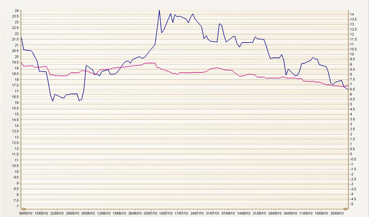

And the result is not correct as bellow...
How can take in account the left and right axis ?
Thanks for your help...
