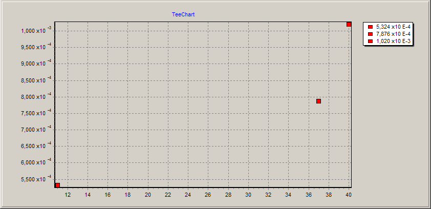

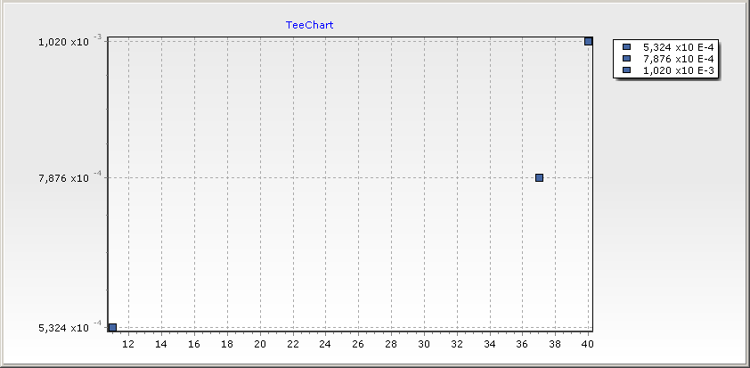

In TeeChart v2010 there is an AxisStyle named PointValue, only available at designtime for now. With it and the code above, the chart looks as follows:
In v7, the same code produces the following result:

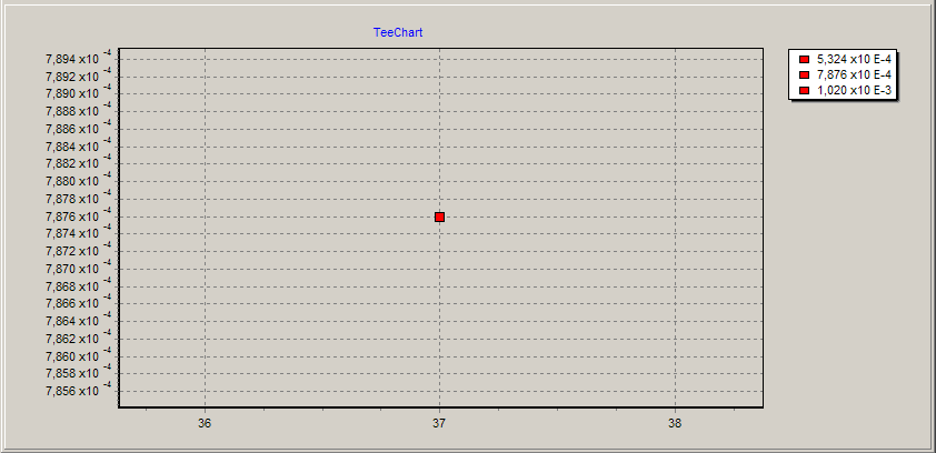

And zooming around the second point, it looks as follows:
Isn't it what you are trying to achieve?
