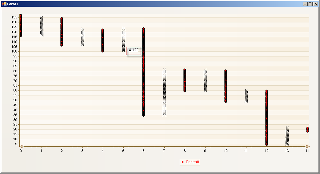

but it still doesn't work fine: the displayed value is the same for the whole column, although different point where clicked
and sometimes i get a value displayed even when i click outside the serie
i attached a screenshot with an example of the result i get
do you have any suggestions?
thanks in advance

guilz2010 wrote:the displayed value is the same for the whole column, although different point where clicked
The Clicked function gives different indexes and thus the example shows different values in a same column for me with the Delphi example I posted.
I haven't seen what could be but I guess it has to be a difference that is affecting the behaviour.
guilz2010 wrote:and sometimes i get a value displayed even when i click outside the serie
I've seen in your calcRect function you use the Cursor.Size to calculate the rectangle width and height. I see in ActiveX you can't access to the asPointFigure.Pointer property (I'll add it to the wish list for future releases) but the values given by Cursor.Size may be wrong. I'd try using hardcoded values, for example 5 pixels width and height.
Just one tip: To test the rectangles calculated, you could draw them at the end of the Clicked function:
    Chart1.Canvas.Rectangle(Result);
And call the Clicked function at OnAfterDraw event to have a more stable draw:
  Clicked(PointFigure1,0,0); //just for the rectangles drawing, the X and Y are irrelevant
