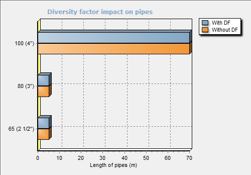

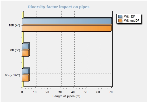

As you can see in the image attached, in version 8.0.0.5, the blue horizontal bar well overrides the orange bar (there are both on the same z-axis coordinate). But with the last update the orange bar overrides the blue one (as if the blue bar is drawn deeper on the z-axis).
Good version
2012-10-09 - v8.0.0.5.jpg (59.47 KiB) Viewed 7082 times
Bad version
2012-10-09 - v8.0.1.3.jpg (59.74 KiB) Viewed 7074 times

You are right. This was broken with v8.0.1.0, but it works fine with the actual v2012.0.0.7. So the options I see:
- Upgrade to the actual v2012.0.0.7
- Go back to v8.0.0.8.
- Try to find a workaround for the latest v8, v8.0.1.3. I can't think on anyone right now. Note the Bar series has been deeply modified in v2012.
