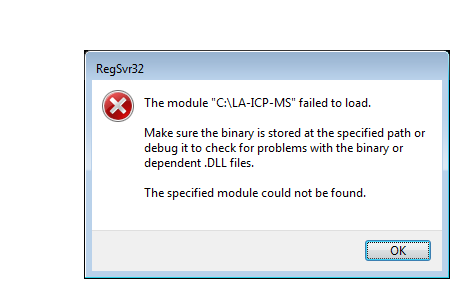

I tried to register teechart on the target computer ,but I failed. I installed my software to c:\la-icp-ms mapping,and run regsvr32 c:\la-icp-ms mapping\TeeChart2013.ocx,error occurs,see my attached file. The target computer is win7(64bit).I checked the folder of " la-icp-ms mapping" and I have found TeeChart2013.ocx in it.

Re: How to publish my program?
Since the path has spaces, try using "":
regsvr32 "c:\la-icp-ms mapping\TeeChart2013.ocx"

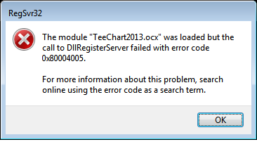

I registered Teechart2013 on a computer with window 64 bit successfully,but when I tried to register it on another computer with window 7 64bit,error happened.See my image.

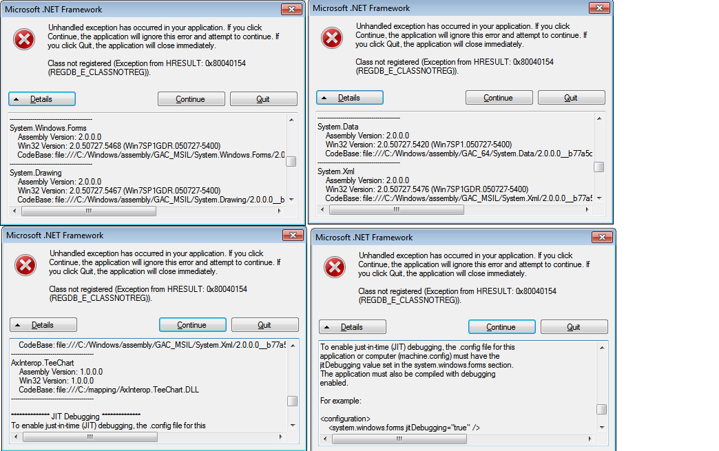

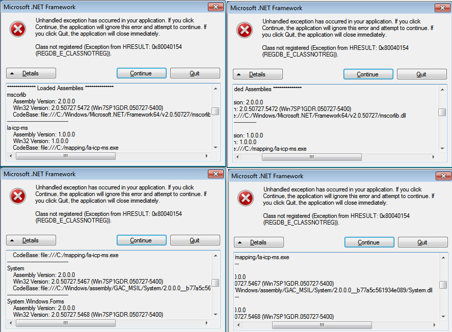

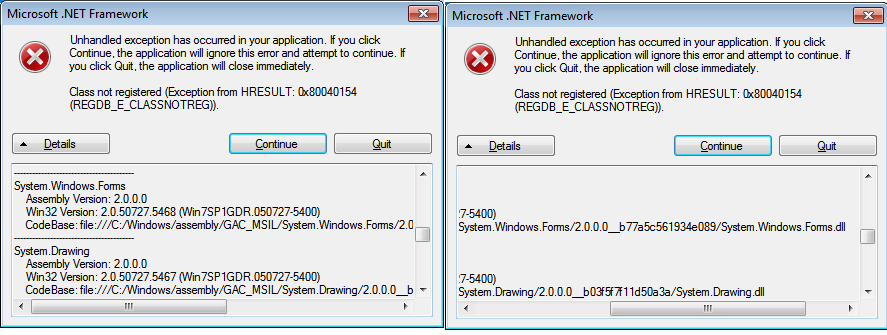

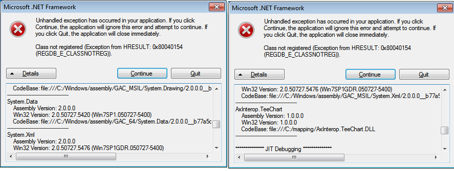

Thanks for your quick reply.I registered your teechart2013 on computer window7 64bit,and computer told me my register is successful,but when I run winform with your teechart,errors appeared.I installed my program in folder of c:\mapping,and I registered Teechart2013:
1. Click on Start button > type Command Prompt > (right click command prompt and click run as Administrator)
2. Reregister Teechart2013.ocx using command:
cmd > regsvr32 c:\mapping\teechart2013.ocx
Computer told me register is successful. I caught errors on screen to you,please help me to sovle it.
Thanks in advance,
Robinson,
Thanks in advance,
Robinson,
- error1
- error1.png (31.11 KiB) Viewed 31262 times
- error2
- error2.png (65.27 KiB) Viewed 31237 times
- error3
- error3.png (58.11 KiB) Viewed 31244 times

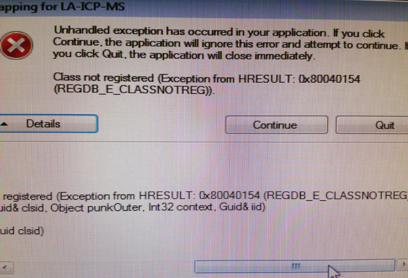

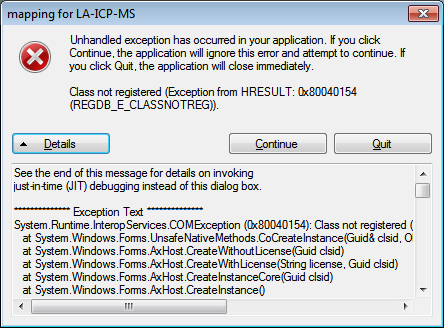

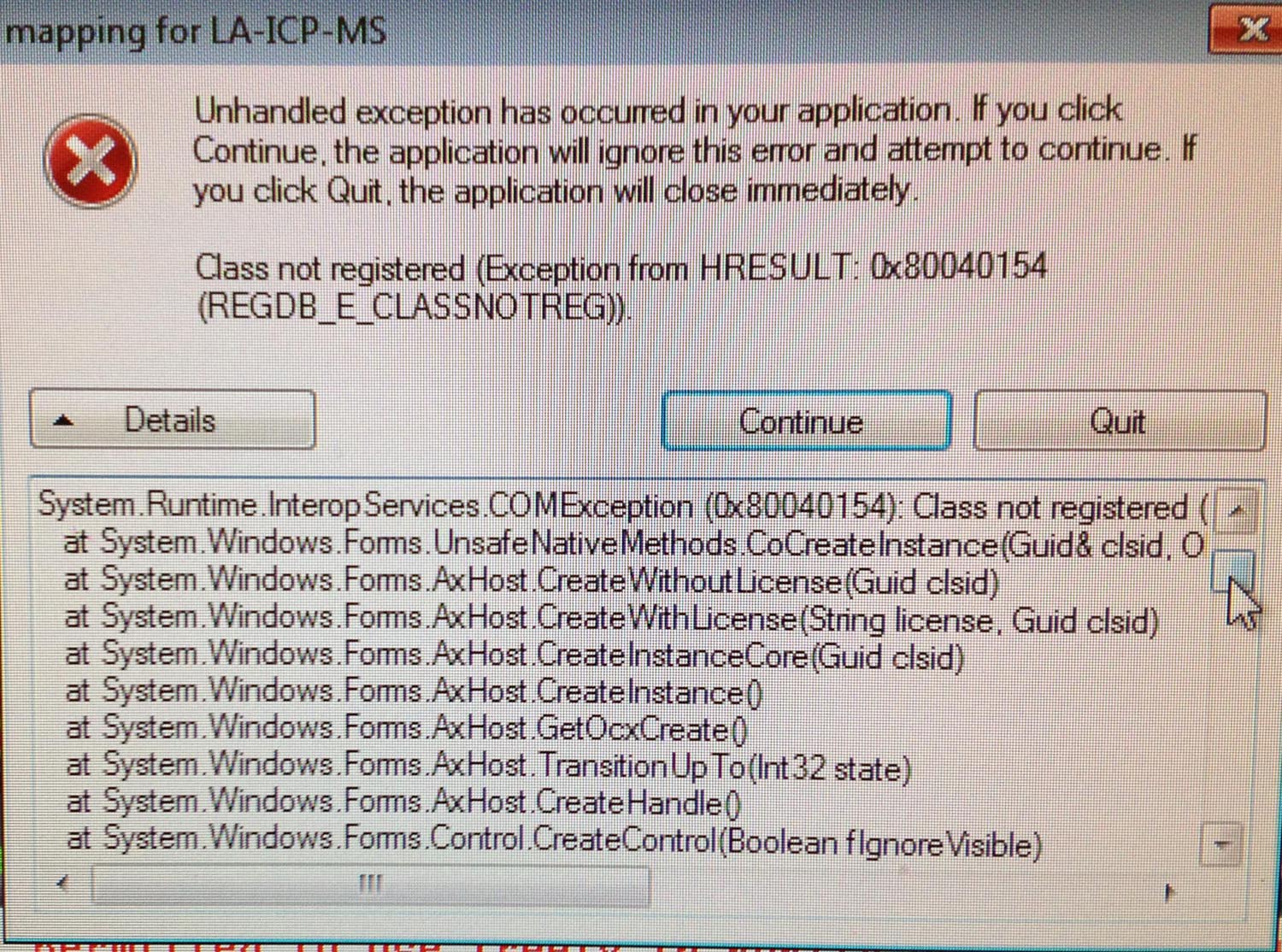

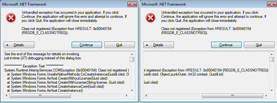

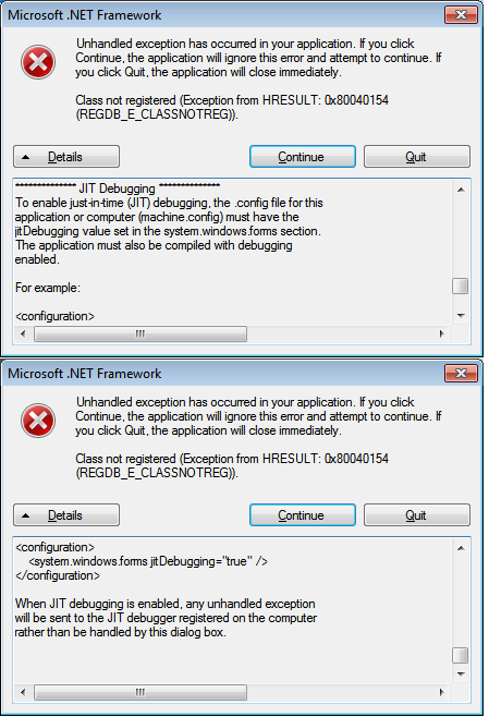

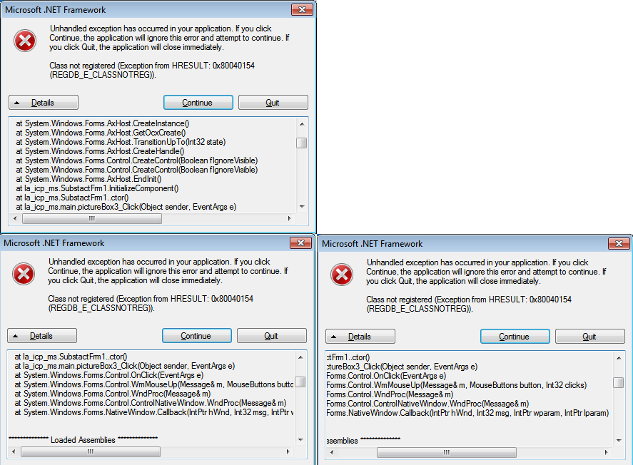

next errors
- error6
- error6.png (32.42 KiB) Viewed 31260 times
- error5
- error5.png (29.93 KiB) Viewed 31252 times
- error4
- error4.png (57.66 KiB) Viewed 31255 times

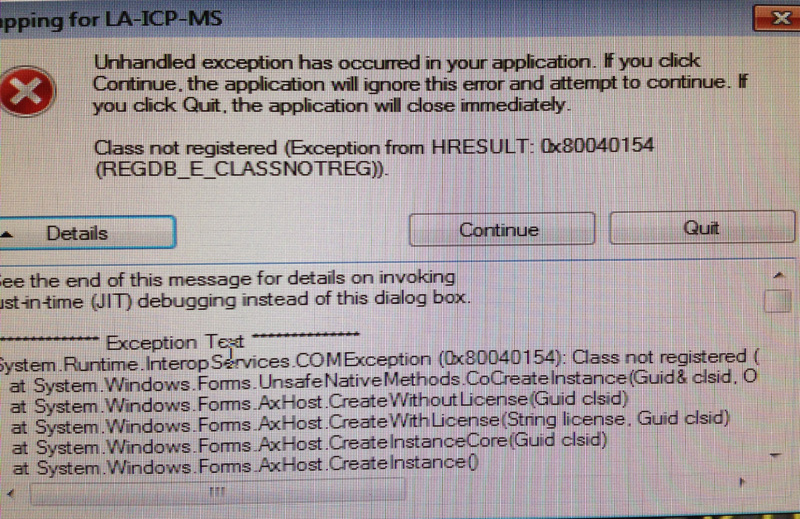

the last error interface
- error7
- error7.png (35.11 KiB) Viewed 31242 times

Hi,Yeray,
I see:http://www.teechart.net/support/viewtop ... t=14454,It told me compiling the application at 32 bit instead of 64.I just complied the application at 32bit,but errors happens on target window7 64bit.
Do I either compile my program at 32bit, copy it directly to my disk and regsvr32 it?or just compile my program at 64bit?

Hi,Yeray
I tried to compile my project to X64,but error appeared still.Winform with color grid can be used firstly,but winform with fast line can not be used.After I ran the winform with error,Winform with color grid can not be used again.
Please help me to work it out.Here is the error image after I compile my project at x64 and use it on window 7 64bit.
Robinson

Hello Robinson,
I understand your development platform is VS2008 C# in Win7 32bit. If you are compiling your project as a 32bit application you should be able to move the exe with the ocx to both a 32bit and a 64bit machine along with the TeeChart2013.ocx from the TeeChart installation folder.
As a test, you could try with the TeeChartv2013FeatureDemo.exe demo shipped with the installation. Find it at the "\Examples\Visual Basic\TeeChartAXV2013Demo" folder in your TeeChart ActiveX installation.
- Does the TeeChartv2013FeatureDemo.exe demo run in your development machine?
Copy the TeeChartv2013FeatureDemo.exe and TeeChart2013.ocx to the deployment 64bit machine. Register the TeeChart2013.ocx running regsvr32 as an administrator.
- Does the TeeChartv2013FeatureDemo.exe demo run in your deployment b4bit machine?
A 64bit OS should be able to run programs compiled both in 32 and 64bits. More on this here and here.zrandlbs wrote:I see: http://www.teechart.net/support/viewtop ... =1&t=14454, It told me compiling the application at 32 bit instead of 64.I just complied the application at 32bit, but errors happens on target window7 64bit.
