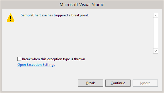

The only message I see is a "SampleChart.exe has triggered a breakpoint" as soon as I close one of the multiple windows with 2 charts. Once it arrives, it continues showing over and over: Then, sometimes I also get a "Debug Assertion Failed" error: Changing your application from "Debug" to "Release" I can close all the windows without getting anyone of the above.

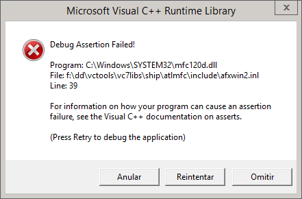

I just downloaded TeeChart2015_0_0_0_ActiveX3264.exe from your website, uninstalled the previous version, restarted the machine and installed the new version. When I ran the demo application and dragged the windows there were no '2." message boxed but I came across a message box with "3." written inside (refer to the attached screen dump). The frequency of this message box is less than that of "2" and the same exception was reported on the output window.
Just to let you know that we are going to have an important delivery shortly and this message box issue has to be resolved before that and we have no solution for it. Please look into the issue and let us know how to fix.This is urgent!

Any update to my last response? Please let me know if you can reproduce the same ("3." message box) on your end and if so why are these message box appearing.
