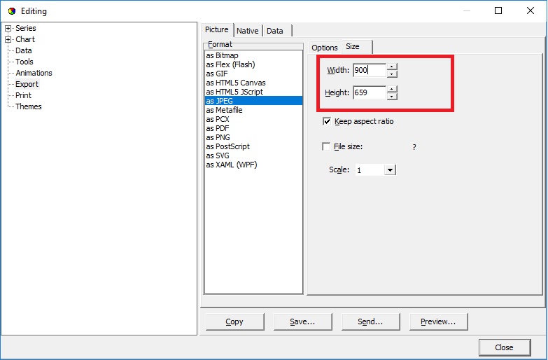

Resize exported image issue.
Post by Bhanu » Sat Aug 11, 2018 6:58 am
In Latest Teechart 2018 Pro ActiveX, I am not able to update size i.e. width and height of exported image in JPEG format as shown in attached snap shot. Though in old teechart ActiveX Pro v7 it was working fine. Kindly guide us the way to resize exported image from teechart for JPEG format.

Post by Yeray » Tue Aug 14, 2018 9:29 am
You are right. I've added it to the public tracker:
http://bugs.teechart.net/show_bug.cgi?id=2071
Thanks for reporting it.
