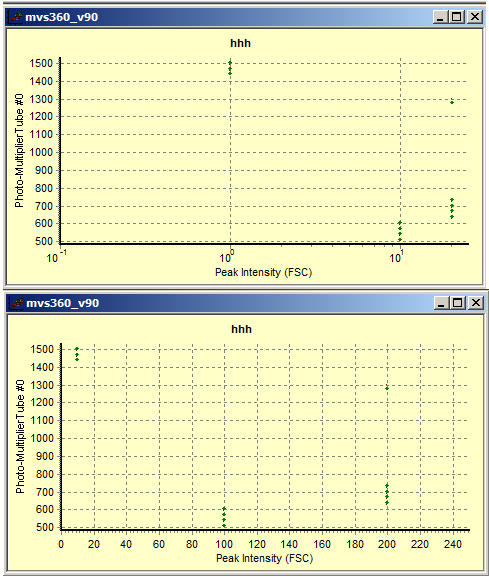

I tried using the "IAxisLabels.Exponent" set to TRUE to get exponent super scripts using the ValueFormat of "00e-0".
It looks real nice, but the tick labels are wrong. When I plot linear the ticks line up with my data just right. The when I change to a log scale and this formating the values displayed are "10 with superscript of 0" for the 100s tick, for the 1000s I get "10 with a superscript of 1"
I've upload an image
- Log Axis Labels wrong
- LogAxisLabelError.png (16.07 KiB) Viewed 14920 times

I don't think axis labels are wrong. It's just that they are set in a logarithmic scale now and therefore they are not on the same position as in al linear scale. Try using the code below commenting in and out the ValueFormat line and you'll see how axis change with logarithmic scales.
Hope this helps!

Sorry I was not clear.
What the two plots show the same data with an x-axis linear (bottom image) and then plotting the x-axis using log scale (top image).
The left three data points plot at "10" in linear and 10^0 ( which is 1 ) in log. I think it should of been 10^1
The middle three data points plot at "100" in linear and 10^1 ( which is 10 ) in log. I think it should of been 10^2
The right four points plot at "200" in linear and the 10^1.1 ( which is ~12.59 ) in log. I think it should of been 10^2.3
Note: I used ^ to show 10 raised to the power of.
I hope this clears up my concern.

If I understood well, you could solve it using OnGetAxisLabel event:
Private Sub TChart1_OnGetAxisLabel(ByVal Axis As Long, ByVal SeriesIndex As Long, ByVal ValueIndex As Long, LabelText As String)
If Axis = 3 Then
LabelText = Format(Val(LabelText) * 10, "00e-0")
End If
End Sub

Yes,
I could solve the problem by doing the coding and handling the event myself.
Basically I'm saying is that your charting library is in ERROR and are you going to fix it?

Yes, I've added this to the wish list to be fixed in future releases (TV52014469).
