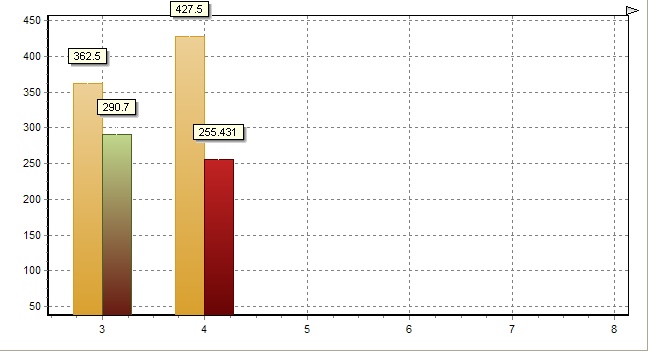

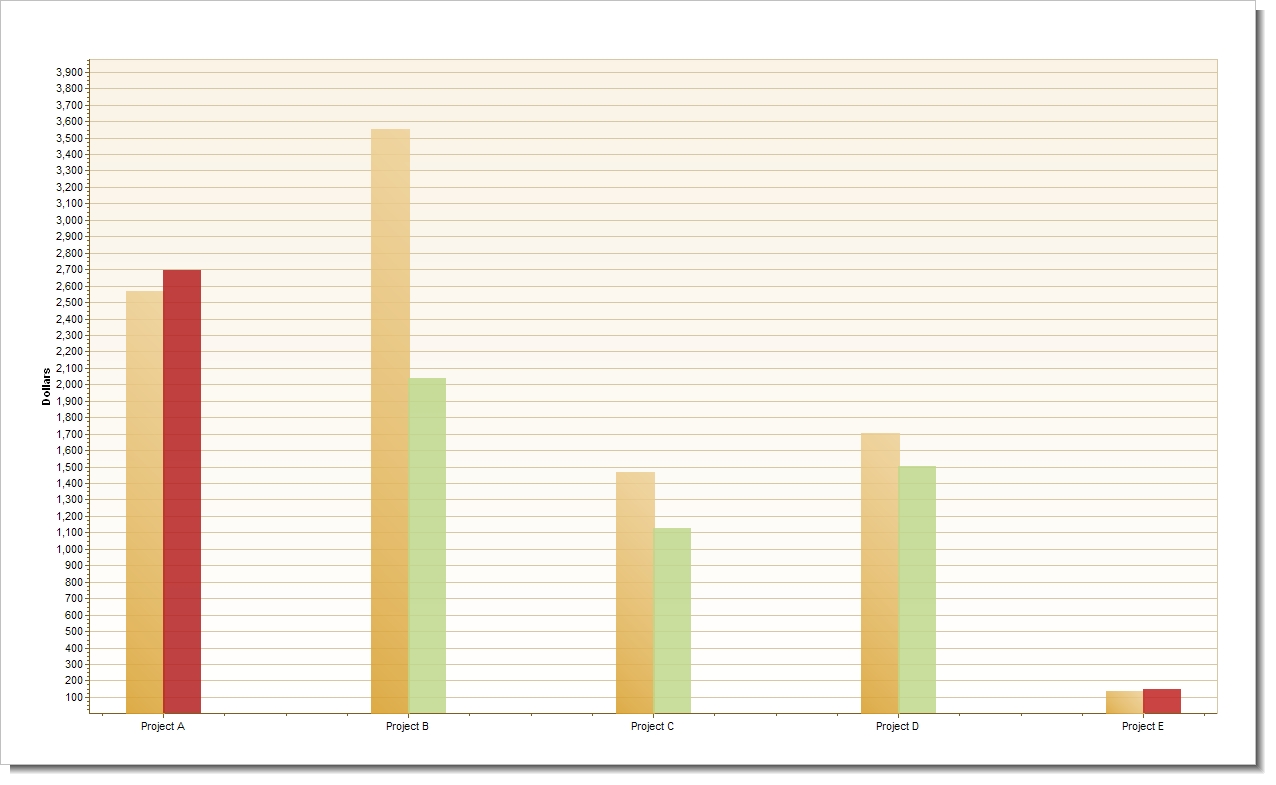

The values of the bar can vary. I attach an image of the bar graph.
What I want to do is to put gradient on the red series from darker red to lighter red and on the green series from darker green to lighter green. I already tweaked around with adding 2 separate series stacked on top of each other (Red and green), but when I showed the marks, the marks show for both of them.

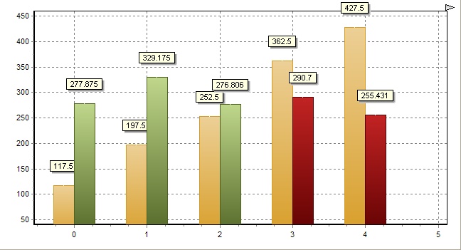

Oh ... I am sorry. I did not realize OnGetSeriesBarStyle is an event. There is another problem, though. If I scroll horizontally, if the color of the first value is green and the color of the second value is red, and the bar is right on the left edge, the gradient will change from red to green.]
Original
After scroll

Yes, I think that the following code works better. Note that the colours assignment should be recalculated if your data changes:
