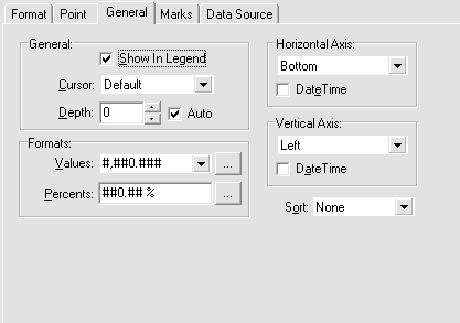

Hello all,
Is it possible to embed the series format panel into another dialog?
What I want to so is have the panel below (Format, Point, General and Marks (I don't want "data source")) in my own dialog so a user can format the series.
Thanks in advance,
Tony.
Thanks in advance,
Tony.
- Series panel contents.jpg (30.22 KiB) Viewed 25070 times
