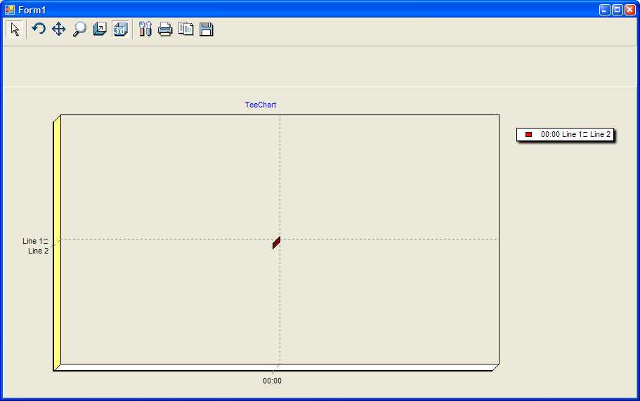

See the attached image.
I selected Axis->Labels->Style->Multi-Line, and then tried setting the x axis label to have two rows.
But I get the strange character. I initially tried sending a Unicode string, then tried a UTF8 string, both have the strange character in it.

I've got
CString strModifiedTitle.Format(_T("Line 1\nLine 2"));
pTChart->Series(0).GetAsGantt().AddGantt( 0 , 0 , 0 , strModifiedTitle);
And I get "Line 1[] line 2" (so not multi line any more). The "[]" is the funny character I reported originally.
It's the Unicode build if that makes any difference.

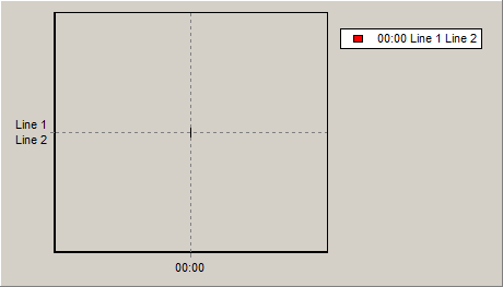

The following seems to work fine for me in VC++ 6.0
m_Chart1.AddSeries(scGantt);
CString strModifiedTitle = "Line 1\rLine 2";
m_Chart1.Series(0).GetAsGantt().AddGantt( 0 , 0 , 0 , strModifiedTitle);

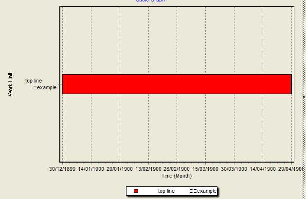

I've uploaded it (the file is called TChart_funny_charsLatest.jpg).
All I did was build the test project and run it.
Let me know if you need anything else.
Tony.
Tony.

Here is the file again.
- TChart_funny_charsLatest.jpg (22.85 KiB) Viewed 21339 times
