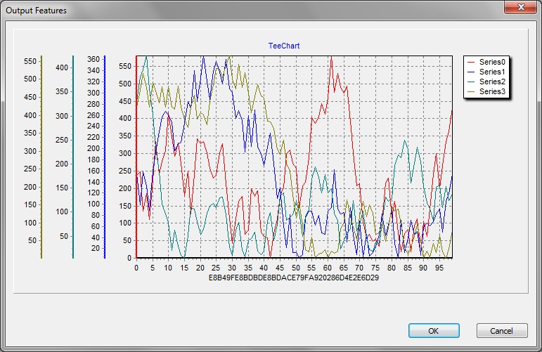

Post by David » Wed Nov 03, 2010 6:44 am
I have read the post http://www.teechart.net/support/viewtopic.php?t=6339 using CodeUTF8String, but the error still exists when I added Chinese for axis title. I am using TeeChartAX8Unicode version. The code I use is m_chart1.GetAxis().GetBottom().GetTitle().SetCaption(m_chart1.GetEnvironment().CodeUTF8String(_T("负载转矩 (mN.m)"),FALSE)); and the display are some HEX series. If I change FALSE to TRUE in the CodeUTF8String, the display will be some squares. I attached the picture FYI.
FALSE in CodeUTF8String
So would anyone please show me how to display correctly? Thanks.

Hello David,
Sorry for the delay. We have done different tests with c++ and your Unicode characters. Result of this, has led us to the conclusion that there is a problem with text import. So, tomorrow we will try to send you a specific version of ActiveX for you.

I have tested the fixed version and it works well with all words displayed correctly. So can I distribute the file you sent me instead?
