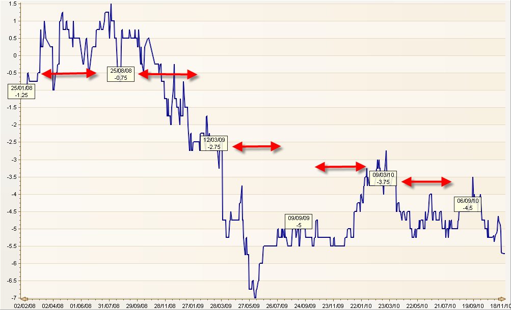

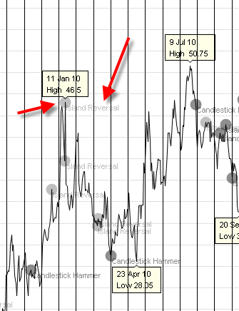

2 - My need is to display information on my chart (a symbol and a text -> gray circle and Island Reversal text in my example)) like in the chart bellow:
What is the best way to do this ?

Guilz wrote:2 - My need is to display information on my chart (a symbol and a text -> gray circle and Island Reversal text in my example)) like in the chart bellow:
Here you have a simple example showing how to achieve a chart similar that the picture you've attached:
Private Sub Form_Load()
  TChart1.Aspect.View3D = False
  TChart1.AddSeries scFastLine
  TChart1.Series(0).FillSampleValues 1000
  TChart1.AddSeries scPoint
  With TChart1.Series(1)
    .Color = RGB(10, 10, 10)
    With .Marks
      .Visible = True
      .Transparent = True
      .Font.Color = vbGrayText
      .Arrow.Visible = False
      .ArrowLength = -15
    End With
    With .asPoint.Pointer
      .Style = psCircle
      .Pen.Visible = False
      .HorizontalSize = 8
      .VerticalSize = 8
      .Transparency = 50
    End With
  End With
  Dim i, c As Integer
  For i = 0 To TChart1.Series(0).Count - 1
    If i Mod 75 = 0 Then
      c = Rnd * 255
      TChart1.Series(1).AddXY TChart1.Series(0).XValues.Value(i), TChart1.Series(0).YValues.Value(i), "point nº" + Str$(TChart1.Series(1).Count), RGB(c, c, c)
    End If
  Next i
  TChart1.Axis.Bottom.Labels.Style = talValue
End Sub

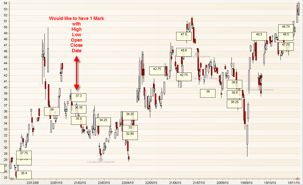

I have an another issue with marks:
We use marks on chart and create function to let space between marks (for readability problem)
But on Candle Chart we would like to have the same logic with only 1 mark (Open, Close, High, Low and corresponding date) and not one mark for Open one mark for close one mark for High like in the screen shot bellow...
How can we do that ?
Thanks for your help
Guilz
Re: Display text and symbol information on a chart
Post by Sandra » Thu Nov 25, 2010 4:38 pm
Hello Guilz,
You can use in OnGetSeriesMark event a code as the next:
TeeCommander1.Chart = TChart1
TChart1.AddSeries scCandle
TChart1.Series(0).FillSampleValues (5)
TChart1.Series(0).Marks.Visible = True
End Sub
Private Sub TChart1_OnGetSeriesMark(ByVal SeriesIndex As Long, ByVal ValueIndex As Long, MarkText As String)
MarkText = "Data:" & Str$(TChart1.Series(0).asCandle.DateValues.Value(ValueIndex)) & vbCr & "Open" & Str$(TChart1.Series(0).asCandle.OpenValues.Value(ValueIndex)) & vbCr & "Close" & Str$(TChart1.Series(0).asCandle.CloseValues.Value(ValueIndex)) & vbCr & "High" & Str$(TChart1.Series(0).asCandle.HighValues.Value(ValueIndex)) & vbCr & "Low" & Str$(TChart1.Series(0).asCandle.LowValues.Value(ValueIndex))
End Sub
Could you tell us, if code works as you want?
I hope will helps.

It is not working fine for me -
For Candle chart type, I would like to have less Marks for readability problem.
In fact .Marks.DrawEvery property does not work fine with candle type (see my picture to understand the problem)
Guilz
Post by Sandra » Fri Nov 26, 2010 8:56 am
Hello Guilz,
I couldn't reproduce your problem using TeeChartAcitvex2010 and next code:
TChart1.Series(0).FillSampleValues (25)
TChart1.Series(0).Marks.DrawEvery = 2
End Sub
End Sub
Could you please, send us a simple project or modify previous code? So we can reproduce your problem here. Moreover, you can tell us which version of TeeChart ActiveX are you using now?
