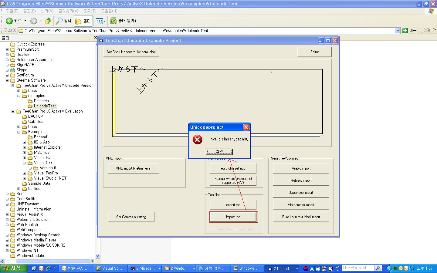

I have a question.
I am using TeeChart Pro v7 ActiveX.
But Some series have error.
1. Choose one of series that Extended_Polar ,Extended_Radar,Extended_Polar Bar,Extended_Smith or Other_Wind Rose.
2. Add the series and set Random Data.
3. After that, Export [TChart1.Export.asNative.SaveToFile App.Path & "\teefile.tee", True] function.
4. And Import [TChart1.Import.LoadFromFile App.Path + "\teefile.tee"].
5. Then, there is an [Invalid class typecast] message box. So, I have to quit APP.
I tested your Sample program [C:\Program Files\Steema Software\TeeChart Pro v7 ActiveX Unicode Version\examples\UnicodeTest\UnicodeProject.exe].
But It had same error.
I attached an error image.
Confirm, and answer me please.

- teechart_polarerror.JPG (155.22 KiB) Viewed 30119 times
