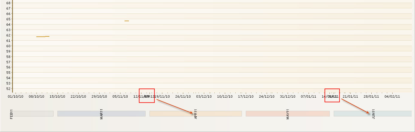

Post by guilz2010 » Mon Nov 07, 2011 12:54 pm
with Teechart v2011 we still have this bug
As you can see, we have 2 series (1 as fast line - Serie1, 1 as Gantt - Serie 2) the issue is that Gantt label are displayed on the bottom axis and we can't see the date labels of serie 1
We do not want to view Gantt labels on bottom axis but we want view them on Gantt chart (Months FEB11, MAR11, APR11, MAY11, JUN11 must be displayed on gantt chart but not on bottom axis where there is already date labels of serie 1
Thank you for your help

Posts: 9562
Re: Labels issue with 2 series
Post by Yeray » Tue Nov 08, 2011 12:14 pm
I've verified with v2010.0.0.1 this reproduced the problem but not now with v2011.0.0.4:

However, the code from Petar, in the beginning of this thread still reproduces the overlapping problem:
Private Sub Form_Load()
  Dim i As Integer
  Dim value As Double
  TChart1.Aspect.View3D = False
  TChart1.Axis.Bottom.Labels.DateTimeFormat = "dd/mm/yy"
  TChart1.AddSeries (scFastLine)
  TChart1.Series(0).asFastLine.TreatNulls = tnSkip
  TChart1.Series(0).XValues.DateTime = False
  value = 45
  For i = 300 To 720
    value = value + 0.03 * (Math.Rnd() - Math.Rnd())
    TChart1.Series(0).AddXY i, value, Format(Now - 365 + i, "dd/mm/yy"), clTeeColor
  Next i
  TChart1.Series(1).asFastLine.TreatNulls = tnSkip
  TChart1.Series(1).XValues.DateTime = False
  value = 45
  For i = 1 To 720
    TChart1.Series(1).AddXY i, value, Format(Now - 720 + i, "dd/mm/yy"), clTeeColor
  Next i
End Sub
So this could be an slightly different problem than TV52015179.
I've opened a new VCL bug ticket with the code above translated to Delphi, that reproduces the problem for me here with the actual sources (TV52015820).
Excuse us for the confusion generated.
