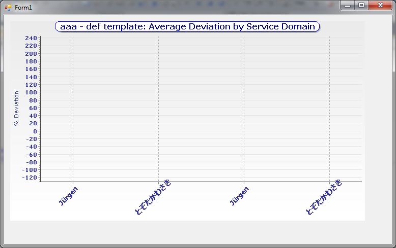

Re: Localization problem: New point in series
Hi Jürgen,
I'm surry but I cannot reproduce the problem here using the latest TeeChart v2010.0.0.3 and your code. I've just imported the your .tee file to the chart at design time and then run your code into the form load method.
I've attached the sample project I've used and also the resulted form image to a this post.
- result.png (47 KiB) Viewed 24963 times
