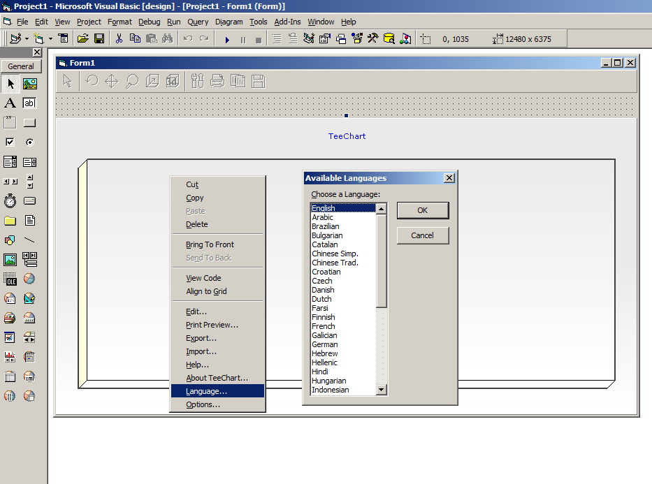

Can you change it in the design time "Language..." option (in the contextual menu)?

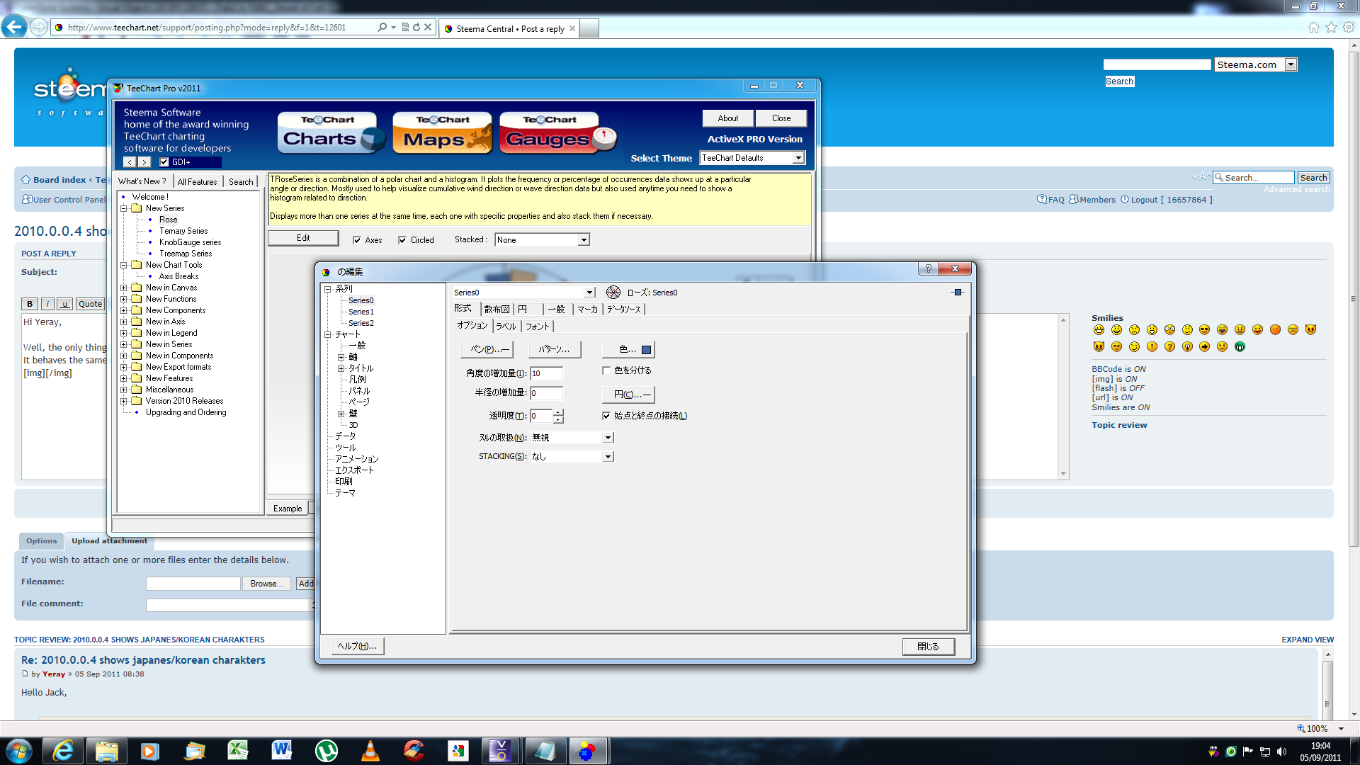

When running the feature demo (new series, rose, edit) it also shows japanese/korean (see attachment).

- Untitled.png (331.32 KiB) Viewed 21077 times

Have you tried to change the language in the "Language..." option at design time, in the contextual menu?

How do I change the language ? Remember I can't read Japanese/Korean.

In VB6, the "Language..." option is the penultimate in the contextual menu, and "English" is the first language in the list. However, in another IDE, the "Language..." option could be into an "Options" submenu.
Re: 2010.0.0.4 shows japanes/korean charakters
Thanks, That did the trick.
