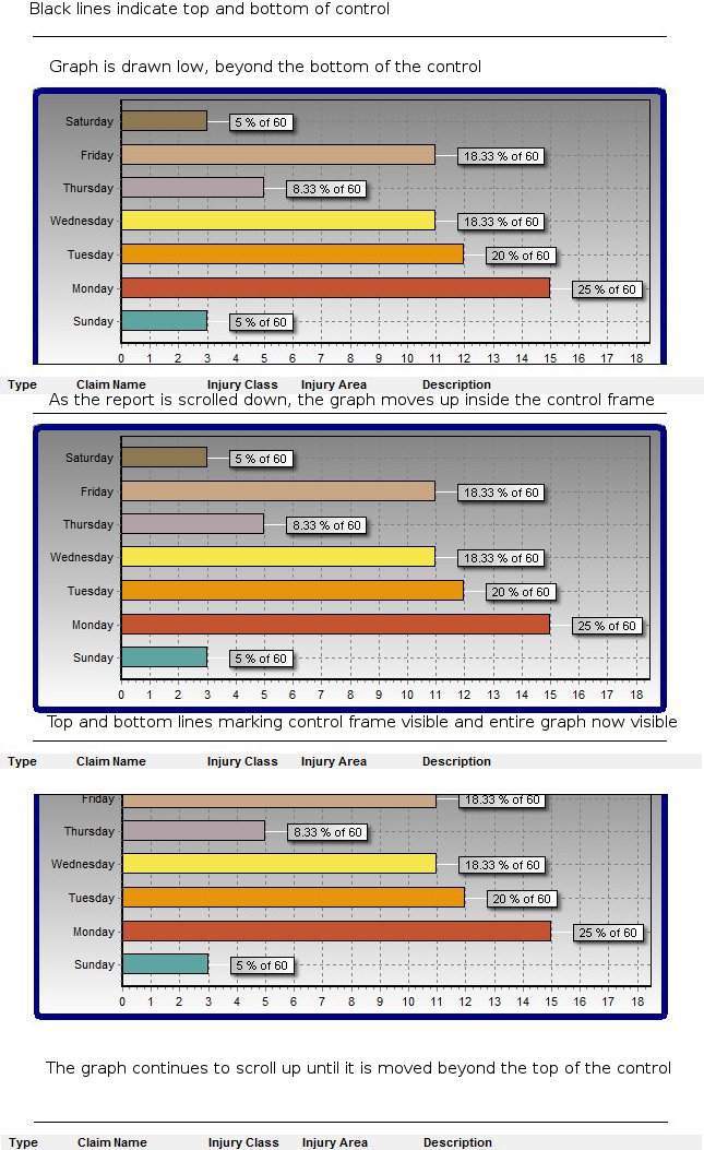

I am having a problem getting the chart to draw properly inside an MS Access report. I am using Access 2010 and TeeChart v8.0.1.1

When I create a new graph on a report, the graph does not draw itself to the borders of the control. There seems to be a second border inside the control border and the graph draws to this inner border. How do I set the dimensions of this inner border? Searching through the forum, I found a reference to the frame. Is this inner border the frame?
When the graph is displayed on the report, part of the graph is beyond the edge of the control, and not displayed. As I scroll the report page, the graph also scrolls farther outside the edge of the control. How do I get the graph to draw correctly on the report page and not scroll outside of the control border?
Thank you
Brad
As the report is scrolled down, the graph moves upwards inside the control borders

ronm wrote:When I create a new graph on a report, the graph does not draw itself to the borders of the control. There seems to be a second border inside the control border and the graph draws to this inner border. How do I set the dimensions of this inner border? Searching through the forum, I found a reference to the frame. Is this inner border the frame?
Can you see this problems in the Teedemo.mdb example shopped with the installation? It should be in your installation folder, into "\Examples\MSOffice\VBA Access".
If it only happens in a new application, could you please send it to us so we can reproduce the problem here?
If it only happens in a new application, could you please send it to us so we can reproduce the problem here?.
It does not happen in the Teedemo.mdb file. I have attached a sample project which replicates the problem.
Thank you for the code. We can reproduce your problem and I have added it in bug list report with number[TA05015779]. We will be try to fix it for next maintenance releases of TeeChart.net.

RonM wrote:It does not happen in the Teedemo.mdb file. I have attached a sample project which replicates the problem.

Hello Brad,
I have sent you an e-mail where there is a specific OCX of TeeChartActivex8 has the bug fixed.
