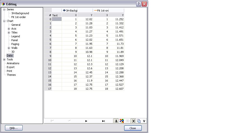

After struggling some time I got the answervector working.
Now the results the answervector presents puzzle me. Below a screenshot of the used data. On the left are the x, y-values of the raw data, on the right are the x,y-vaules of the linear (PolyDegree=2) fit.
The fit is performed via this code:
	otemp:setfunction(tfCurveFit)
	otemp:FunctionType:asCurveFit:TypeFitting:=cfPolynomial
	otemp:FunctionType:asCurveFit:PolyDegree:=SELF:n_fitorder
	otemp:DataSource:=SELF:oDCTC:Series(wie)
	otemp:CheckDataSource()
The fit looks good and plausible on graphics.
When retrieving the corresponding answervector the following two numbers are presented:
answervector[1]=0.272339
answervector[2]=0.079659
Putting the same (raw) data in MS-Excel and fitting a linear trendline through it, the following line is produced; y=0.079659x+11.172680.
So, the calculated slope (0.079659) looks OK (assuming answervector[2] represents the slope with a linear fit).
The offset which TC calculates however looks way off (0.272339 vs. 11.172680).
Could you please explain what is going on.
TIA,
Jack

To eleborate on the above.
When fitting a 2nd order polynome (polydegree=3) through the raw data, the answervector produces this:
answervector[1]=0.435702
answervector[2]=0.018398
answervector[3]=0.003604
MS-Excel calculates on the same data y=0.003604x^2 + 0.011191x + 11.400907
So again, the highest order looks OK, but the lower orders deviate (significantly).
As said above, the grahics looks fine.
Greetings,
Jack
