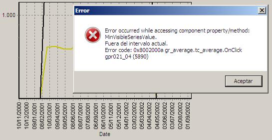

It works fine, but when we zoom in the plot the following error message occurs:
Error message
Please note, that the expected minimum value is 10/11/2000

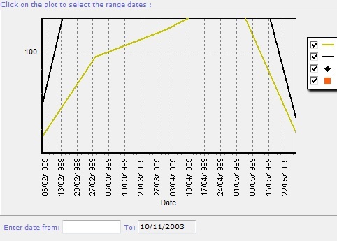

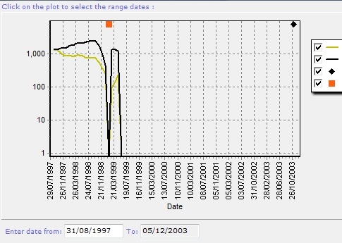

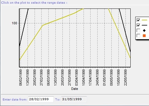

This feature was working perfect with scFasLline series. Two extra scPoint series were added and the bottom axis label style was changed to two:
TChart1.Axis.Bottom.Labels.Style = 2
The current example has only one point in each scPoint serie. We noted that when this scPoint series are unchecked the error disapeared.
The images attached showed the state before and after the zoom in and how the returned values are correct with scPoint uncheked.
1. Before Zoom In the date values returned are correct
2. Zoom In. Returned values do not corresponding with X-axis visible scale. The minimum value returns the error message reported before.
3. ScPoint series unchecked. Returned values Ok.

It's indeed both. The error message appears when you zoom in several times and refers to the minimum value, and, the maximum does not return the correct value when zooming in. However, when you uncheck scPoint, the returned values ​​are correct and no error message when zooming.
