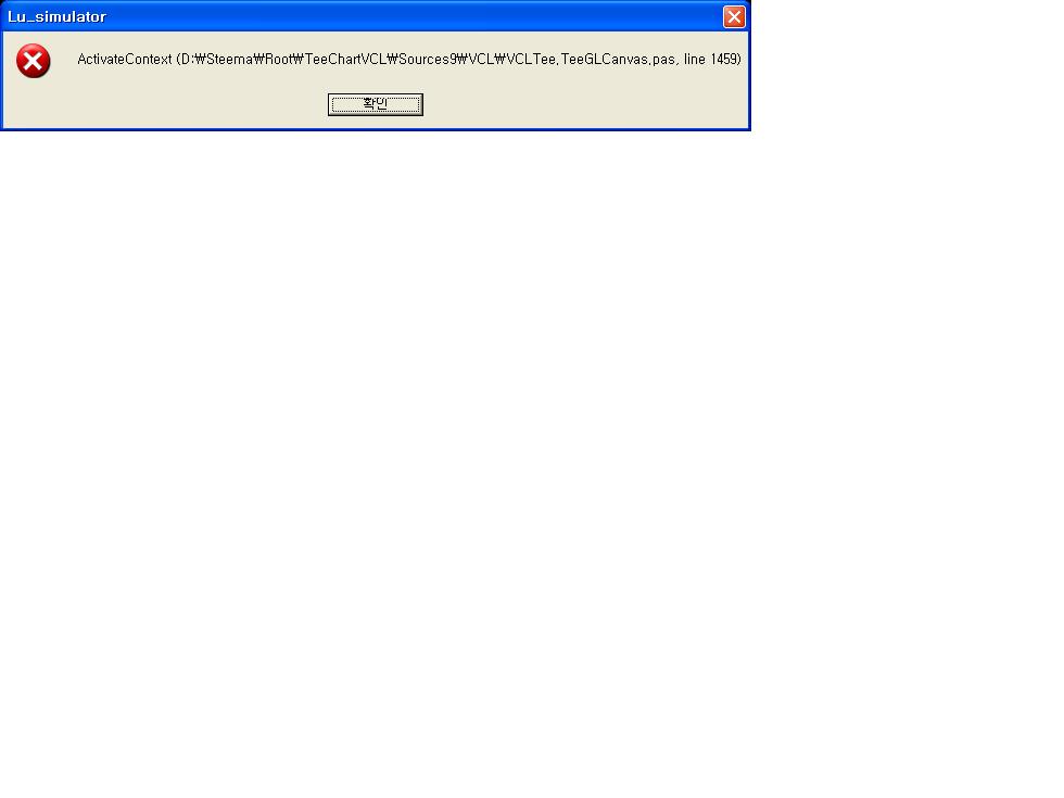

Hi~!
I develop the application with VS2008 SDI environment.
I got some numeric data(3840bytes) on real time(every 1seconds) and push that in TeeChart Series..(Tower, Bubble and so on..)
I express successfully data patten but performance is trouble.
So.. I exchange chart expression type to OpenGL.
m_tcPRPS[idx].GetAspect().GetOpenGL().SetActive(TRUE); //OpenGL Enable
I type that code in my projecct.
And build process is success, but occer Error window .
Error message is "ActivateContext (D:\Steema\Root\TeeChartVCL\Sources9\VCL\VCLTee.TeeGLCanvas,pas, line1459"
I'm very confusing this message.. because my computer is not detect "D" Driver and I can't find "TeeGLCanvas.pas" file.
So I wonder the solution about this situation.
Finally I'm sorry for my english level is elementary..
I'm waiting for your reply~
Thank you~

Re: I can't activate "OpenGL"
Hello pine,
These assertions are used for "debug" compilation, and these should not appear. This bug with number [TA05016396] has been already fixed, and a fix will be included into the next maintenance release.
In the case, you need this fix urgently, please let us know and we'll prepare a specific ocx for you.

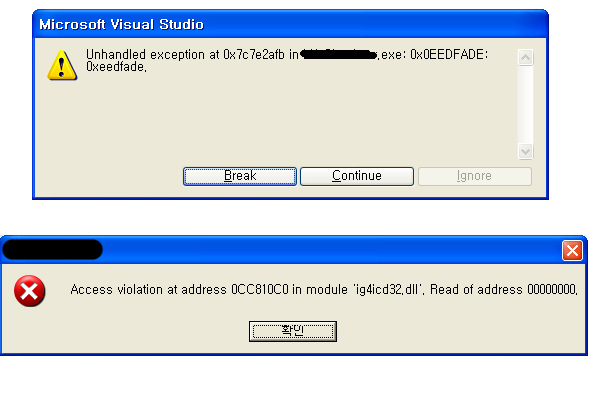

Hi~ Sandra! ^^
I received ocx file yesterday but it worked un-normal action.
First of all, OpenGL Chart creation is successful.
But The error window occured when the program terminated.
Error message is "Unhandled exception at 0x7c7e2afb in XXXX.exe : 0x0EEDFADE : 0xeedfade"
I attached the Error Message Window capture image.
And, the another error occured when the program start running.
Error message is "Access violation at address 0cc810C0 in module 'ig4icd32.dll'. Read of address 00000000."
I attached the Error Message Window capture image too.
Hello pine,
I can not reproduce your problem using last TeeChartActiveX.ocx I sent you. Could you please, arrange a simple example where the problem appears, because we can reproduce your problem here?
Hello Sandra.
I tested many times with your New release ActiveX ocx file and TeeChart2011.v5 ocx file.
I think the cause of this problem is Hardware. My notebook's graphic card driver is not recognized and used inner graphic driver(intel graphic)
But, I checked inner graphic's performance that is support OpenGL all version.
And do testing another way by aspect Software.
I created only one TeeChart object(OpenGL Enabled). Than the program is no error.
But I created many (Over than one) TeeChart object(OpenGL Enabled). Than the program is error like above attached image.
Please review below message, and find the solution.
Thanks~!
Thanks~!
Hello pine,
Thanks for information. But we need reproduce your problem here to try solve it and I can not reproduce it. For this reason, we would be very grateful if you can send as a simple project, because we can reproduce exactly your problem here and try to find a good solution for you.
