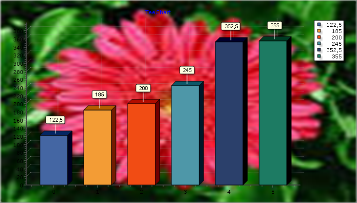

And what would you expect TeeChart to draw when the image is loaded?
If you want to show the image in the background, you could load it in the panel or in the back wall. Something like this:

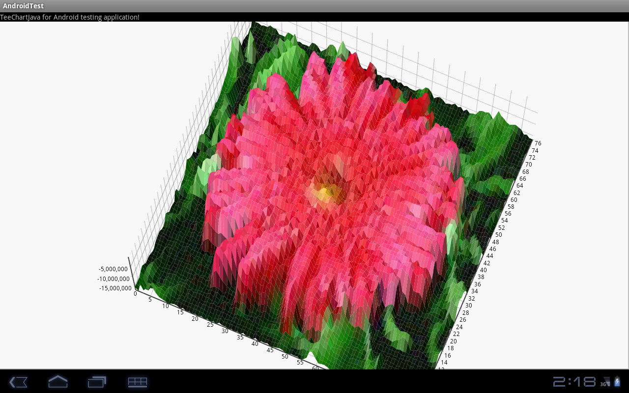

If you want to load the image in a series, you may want to do something like in the image below. We did this example with TeeChart Java for Android:
