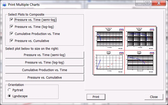

I am writing an MFC program with MDI. I have successfully pulled 4 charts from 4 documents and put them on a TeePreviewPanel. I have not been able to change the printer used by the previewpanel's printpage. What is the TeeChart way to do this?
Dialog
On the dialog with the TeePreviewPanel, I have a button for Printer Setup (ID_FILE_PRINT_SETUP), so it brings up the printer setup via MFC with no code on my part. The print button on this screen calls m_ctrlPV.PrintPage(), where m_ctrlPV is the preview control.

I have done this with 2013 Evaluation, after failing to get this to work with 5.0.6.0. I have attached a jpeg of my dialog.
