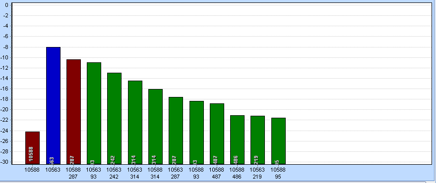

I am trying to put marks on bars. I have mark's text at 90 degrees and style is set to smsLabel (default). If some of the bars have labels set some of the marks do not show correctly:
smsLabel and labels on bar start.png (9.54 KiB) Viewed 16236 times

I tried tinkering with alignment and other usual suspects but found nothing that helped. Only the mark on the first bar is drawn like it should be.

Ok. I made a mistake. Text alignment helps so that marks' text is not clipped but still marks do not start at the same position on the bar.
text align set to left.png (9.26 KiB) Viewed 16280 times

Test application. You can try different text alignment options by changing the code. Anyway, regardless of the text alignment selected labels do not start at the same position on the bar.

Thanks for the example project. I could narrow it down to a simple Delphi example and added it to the bug list [ID466] to be enhanced for future releases. Please bear in mind that TeeChart Pro ActiveX is a COM wrapper of TeeChart Pro VCL, written in Delphi. Therefore the issue needs to be fixed in the VCL version to get to the ActiveX version. Also, if you sign up at the bugzilla platform you'll be able to receive automatic notifications about the status of the issue.
Re: Bar series and marks on bar
Post by Narcís » Fri Nov 22, 2013 3:18 pm
As an update, the issue has been implemented: http://bugs.teechart.net/show_bug.cgi?id=466#c1. it will be included in the next maintenance release.
