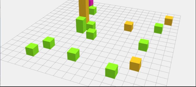

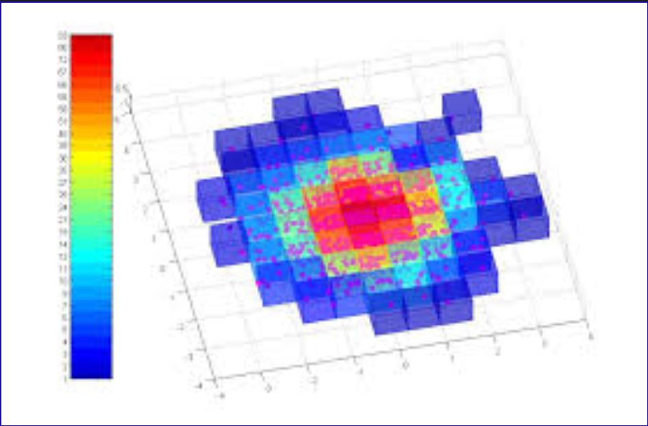

hi~ i'm woon.
Sorry, I can't find the TeeChartFeatures Demo.
i installed TeeChart from the file which is downloaded the download page of your website.
and i attached three picture files that i want to draw using TeeChart.
is that possible?
if you have check that, I am enormously grateful to you.
is that possible?

Re: [repost] How to draw 3D chart?
Hello Woon,
with the TeeChart ActiveX and VB code you could make use of the Tower Series Chart and then change its aspect (orthogonal, zoom, rotated, 3dpercent, axis..). A simple example could be :
Private Sub Form_Load()
TeeCommander1.Chart = TChart1
With TChart1
.AddSeries scTower
.Series(0).asTower.AddXYZ 0, 5, 7, "", clTeeColor
.Series(0).asTower.AddXYZ 2, 3, 10, "", clTeeColor
.Series(0).asTower.AddXYZ 4, 1, 3, "", clTeeColor
.Aspect.Chart3DPercent = 100
.Aspect.Orthogonal = False
End With
End Sub
