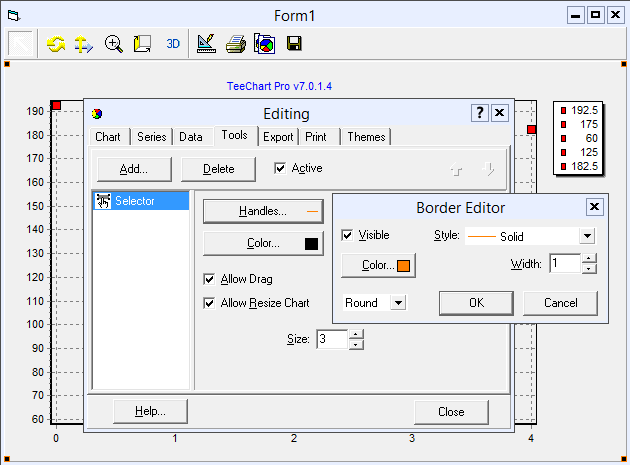

Do you mean the Handle button in the Selector editor?nbp wrote:2) What is the function of the the handles that appear on the chart when selected via Editor -> Tools -> Add Selector?
You can change the pen used to draw the selection squares highlighting the selected element.
