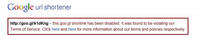

I got the email but the link is not ok.
See the attached image:
[img]LinkNotOk.PNG[/img]
- LinkNotOk.PNG (14.03 KiB) Viewed 38713 times

Excuse me. I'm sending it again.
