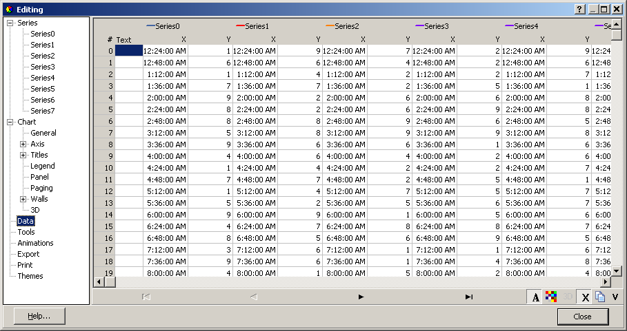

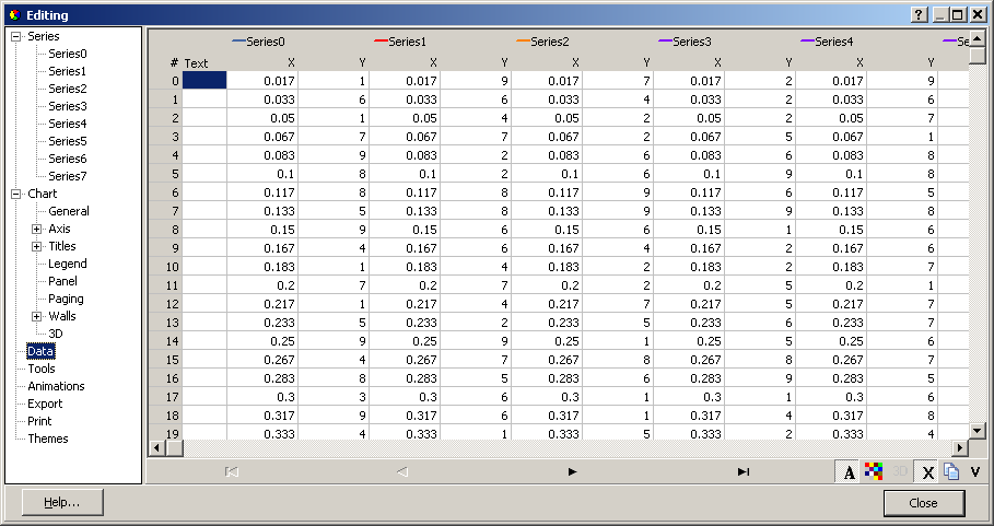

Using Tchart1.ShowEditor, the X Data is as follows:
Accumulated Mode: 0, 0.017, 0.033, 0.05, etc..
Real Time 12 Hr.: 12:00:00 AM, 12:24:00 AM, 12:48:00 AM, 1:12:00 AM, 1:36:00 AM ......
Real Time 24 Hr.: 12:00:00 AM, 12:24:00 AM, 12:48:00 AM, 1:12:00 AM, 1:36:00 AM ......
The Accumulated Mode displays the traces as expected (Correct X Value).
The Real Time Modes display the traces well beyond the end of the graph (Incorrect X Values).
The Y Values for all 3 modes appears to be correct.
As I toggle through each of the different modes, and examine the data with the ShowEditor, the X Values remain constant as listed above.
I do not understand how to correct the X Values for the Real Time Modes.

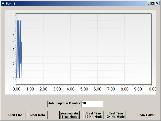

I have included screen shots in an effort to describe the issue.
The screen shots are from a test program I put together to work on this issue.

tirby wrote:Accumulated Mode:
Bottom Axis is correct.
Note X Column Data:
Data is correct.

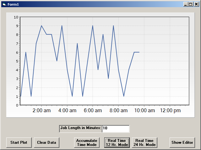

Real Time 12 Hr. Mode:
Bottom axis is incorrect and should read:
(Now – What-ever the current time is.)
11:55 am 11:56 am 11:57 am 11:58 am 11:59 am 12:00 pm 12:01 pm 12:02 pm 12:03 pm 12:04 pm 12:05 pm
Also, the graph is spread out to over half of the chart. Width should not have changed.
Note the X column data:
Should be the same as the Bottom Axis labels. Note that the times skip by 24 Minutes.

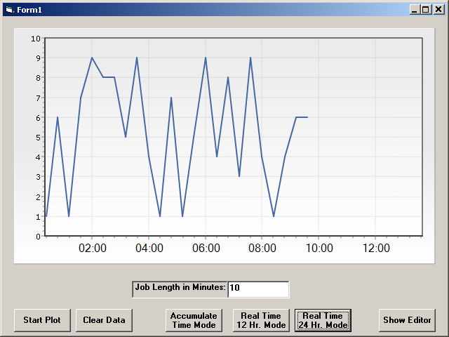

Real Time 24 Hr. Mode:
Bottom axis is incorrect in a similar manner as the 12 Hr. Mode.
The data is the same as the 12 Hr. Mode data.

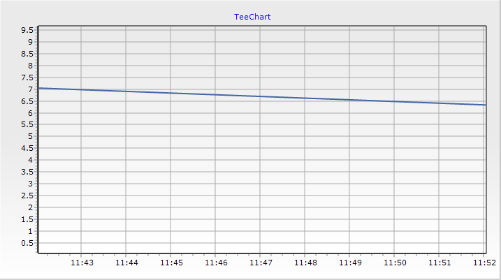

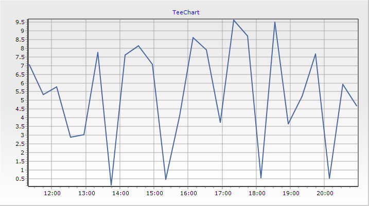

I've made a simple example showing a result similar to yours. The code below gives me this:
Here the code to produce it:
Private Sub Form_Load()
  TChart1.Aspect.View3D = False
  Dim i, j As Integer
  Dim tmpStart, tmpDate As Date
  tmpStart = Now
  For i = 0 To 3
    TChart1.AddSeries scLine
    TChart1.Series(i).Pen.Width = 2
    TChart1.Series(i).XValues.DateTime = True
    For j = 0 To 24
      tmpDate = tmpStart + (1 / 24 / 60) * 24 * j
      TChart1.Series(i).AddXY tmpDate, Rnd * 10, "", clTeeColor
    Next j
    If i > 0 Then
      TChart1.Series(i).Active = False
    End If
  Next i
  'TChart1.Axis.Bottom.SetMinMax tmpStart, tmpStart + (1 / 24 / 60) * 10
End Sub
Note the last line is commented. If you enable it you'll see that changing the bottom axis scale makes the labels to show an increment of one minute:
tirby wrote:Also, the graph is spread out to over half of the chart. Width should not have changed.
This also depends on the axis scale. You probably set a bottom axis scale for the "Accumulated Mode" that should be changed in this "Real Time 12 Hr. Mode".
And the same will probably be happening in the "Real Time 24 Hr. Mode".
