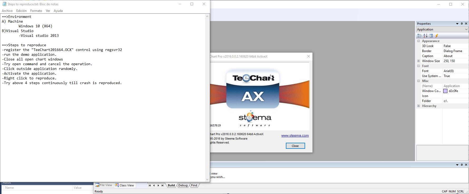

We have developed a sample application to demonstrate the crash in STEEMA charting control.
The application has been developed in Visual Studio 2013 and run on a windows 10 machine.
The below listed files have been uploaded to STEEMA server (under SNPSUSER user):
a) Source Code for a demo application (ZIP file)
b) Screen Recording (ZIP file)
c) Steps to reproduce (TXT file)
Please help investigate and fix the crash ASAP.
Awaiting your response, Thanks in advance.
Re: Crash on Unload
Post by Yeray » Fri Feb 17, 2017 8:59 am
I haven't been able to reproduce the problem.
I've added a call to m_ctrlChart.AboutBox() to show the TeeChart version registered / in use.

Re: Crash on Unload
Post by Yeray » Thu Feb 23, 2017 9:08 am
SNPSUSER wrote:As demonstrated, we could reproduce the crash in X64 bit STEEMA control, both in our main application and the dummy application.
Indeed we observed how you could reproduce the crash in both applications. However, we've spent hours trying to reproduce the crash in the dummy application without much success.
We could reproduce an AV reported in the EventViewer as coming from TeeChart's 64bit ocx, but only one time.
Attaching the process to the TeeChart VCL sources, using RAD Studio, we caught an error another time, but we aren't sure if this is the same problem or a different one. The only information given was the error came from a User32.dll.
Appearing so sporadically, it's very difficult to debug and investigate the root of a problem.
SNPSUSER wrote:As per your direction we deactivate the GDI+ in our project, but it does not resolve our problem.
Have you tried to deactivate GDIPlus just after creating the chart? We think it's worth to insist on this because this is the only similar problem we've found in the last TeeChart ActiveX versions.
		m_ctrlChart.Create(_T("TeeChart.TChart"), WS_CHILD | WS_VISIBLE, rect, this, IDC_GRAPH_CTRL);
		m_ctrlChart.GetAspect().GetGDIPlus().SetActive(false);
Note you'll have to add teegdiplus.hpp from the TeeFiles folder to the "Header Files", and teegdiplus.cpp from the TeeFiles folder to the "Source Files".
And you'll also have to add the corresponding include at the top of the SNPSChartDemoView.cpp:
#include "TeeGDIPlus.h"
After doing this in the dummy project, the application has been running for hours in a machine without errors.
