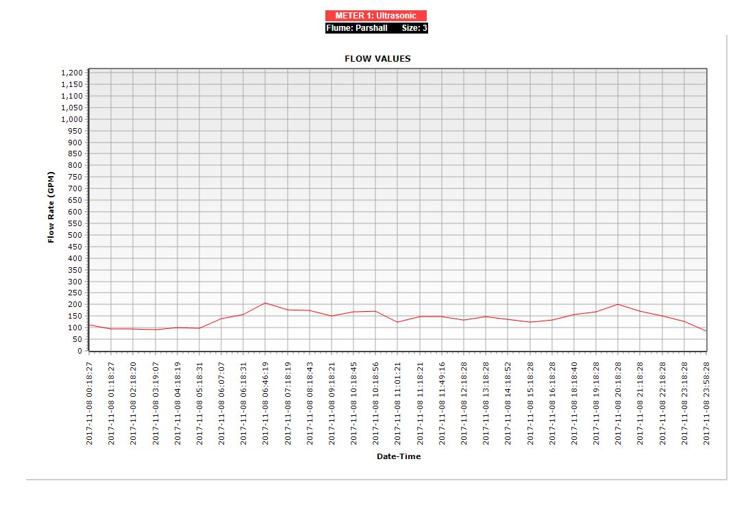

I have recently updated a version 5 application. It uses ASP pages and ADO. Here's a snippet of code:
'DATE/TIME
AChart.Axis.Bottom.Increment = AChart.GetDateTimeStep(dtOneHour)
AChart.Axis.Bottom.Labels.DateTimeFormat = "hh:nn" '****version5 used AChart.Axis.Bottom.Labels.DateTimeFormat = "hh:mm"
AChart.AddSeries(scLine)
AChart.Series(0).Color = vbRed
AChart.Series(0).XValues.DateTime = True
AChart.Series(0).Datasource = Rs
AChart.Series(0).YValues.ValueSource="Value"
AChart.Series(0).LabelsSource="DateTime" '**** version5 used Chart.Series(0).XValues.ValueSource="DateTime"
I expect to have the DateTime on the X axis:
1. be divided into 1 hour segments via AChart.Axis.Bottom.Increment = AChart.GetDateTimeStep(dtOneHour)
2. display DateTime format of hours:minutes via AChart.Axis.Bottom.Labels.DateTimeFormat = "hh:nn"
But it does not display that way. Doesn't seem to be any formatting of the Y axis at all. Is there some order that is required? I feel like I've tried everything to no avail. I have the ASP source code as well as the results of the SQL query but the forum does not allow me to upload.

I see you are setting the "DateTime" field to the Series' LabelsSource:
As you said, in v5 you used:
AChart.Series(0).XValues.ValueSource="DateTime"
I'm not sure to understand why did you change this, but this seems to be the reason of the problem.
- Adding values to a series without specifying the X values, the X values array is populated with a succession of 0, 1, 2,... That's why there's the same horizontal distance between all the points in your result.
- By default, the axis Labels.Style is set to talAuto, and when the axis has a series with labels attached, these labels are used to draw the axis labels. The DateTimeFormat only is considered when displaying values in the axis, not when displaying the labels (strings).

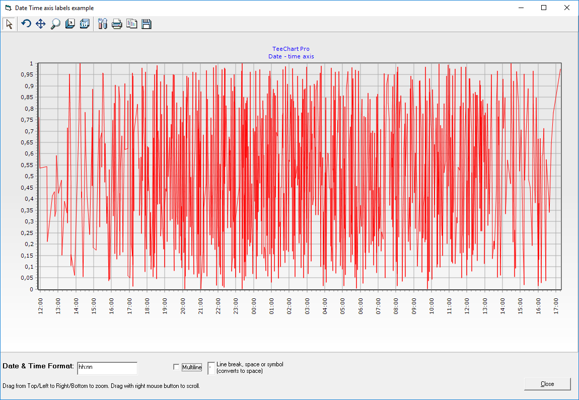

Yes. Those should work. If those lines are not working then there must be some other factor in the code impeding them.
This image is an example, simple VB demo (adapted from example demos shipped with TeeChart AX 2017):
The example uses variably spaced x data at intervals of less than an hour. The asp code should work on this in exactly the same way. I've added the VB(6!) project to this post.
Re.
If I use AChart.Series(0).XValues.ValueSource="DateTime", my chart does not draw. The only way I get my chart to draw is using the AChart.Series(0).LabelsSource="DateTime" method. What am I missing?
"Datetime" is the name of the field, correct?
- If the "Datetime" field contains double values (datetime in double format) then it can be used with AChart.Series(0).XValues.ValueSource
- If the "Datetime" field contains strings then you can use it as the LabelsSource.
Multiline Axis Labels.zip
(3.85 KiB) Downloaded 1825 times
