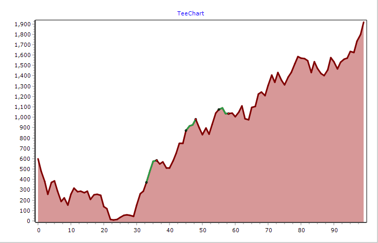

I have an existing line series representing an elevation profile. I would like the user to be able to manually draw a number of new series on top of that profile such that:
  • The new series will 'stick' to the profile - the points of the new series are a sub-set of the profile series.
  • The start and end points of the new series are highlighted and distinct.
  • The start and end points should be draggable.
  • The new series' cannot overlap - dragging the end point of one should 'push' or 'pull' the endpoints of any adjacent series.
So in the above image the user has added the three green lines, the start points are indicated by a green splodge, then end points by a red splodge. The user can then drag these endpoints up and down the profile to make the green lines longer or shorter.

You can use extra line series to draw the green segments and extra point series to draw the start and end pointers for these segments.
Then, you can use mouse events (mousedown, mouseup, mousemove) to modify the series points as you require.
I've written a simple example to start with, but the difficulty here is to write the logic to control all the situations you described and I'm afraid there's no TeeChart feature designed to do it for you.

Thanks Yeray - I tried this and got it working.
But then I found it was simpler to have fewer series' and use OnGetSeriesPointerStyle to do my end marks :)
