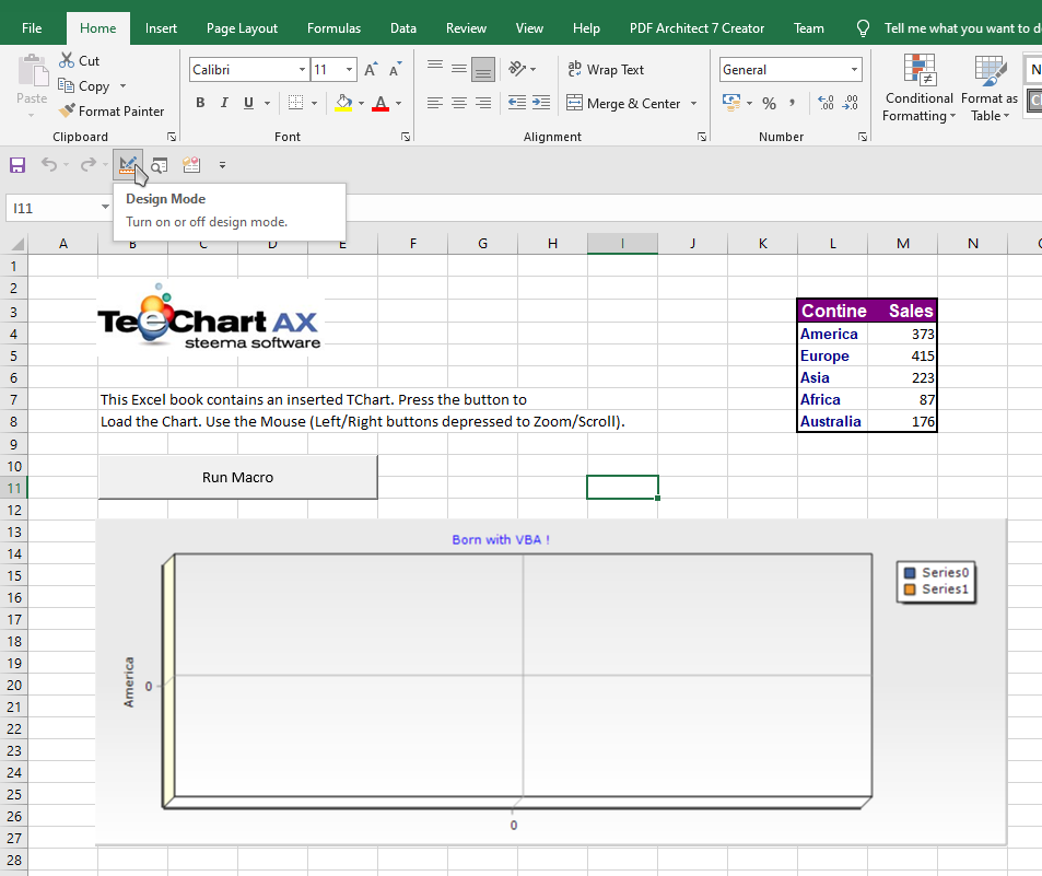

Please make sure you have the "design mode" activated in Excel:
Then you should be able to open the options menu right-clicking on the chart.

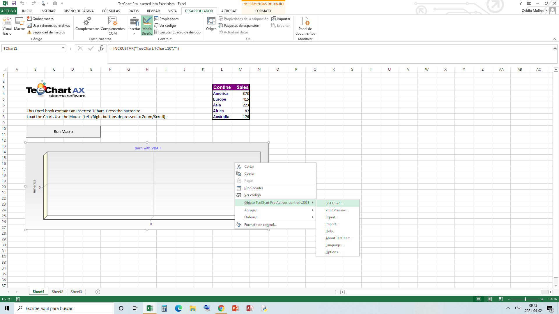

I followed your hint and works perfectly for embedded graphs on Excel sheets.

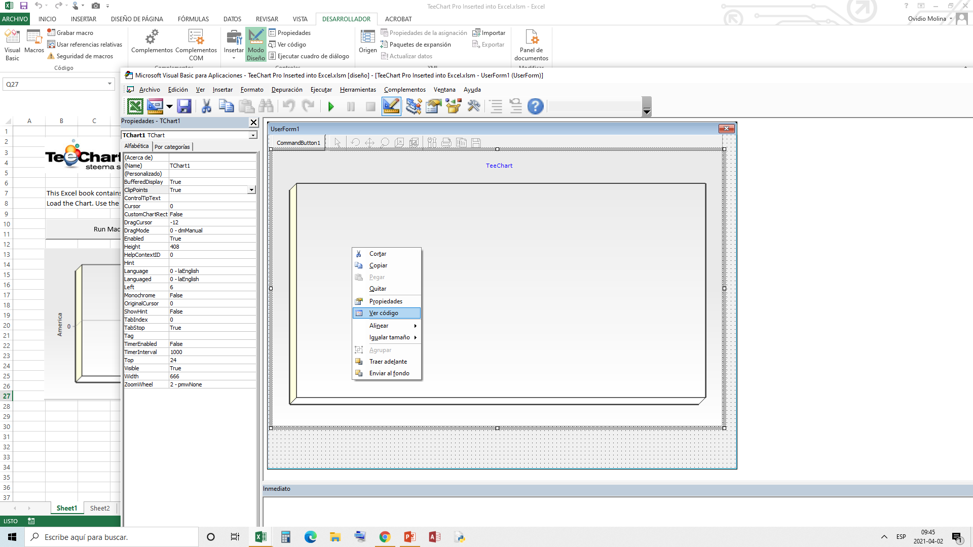

Sorry, but what I was trying to do is editing graphs on user forms in vba.
I turned on the developers mode prior to trying to edit graphs in user forms without success.
This functionality is what I'm looking for. As you can see, the developers button is turned on but no edit option appears in the pop up menu of the tchart control.
Is there something wrong with my software installation, or I'm not looking in the right place ...?

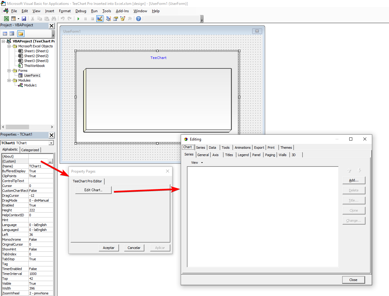

You can open the editor through the properties:
