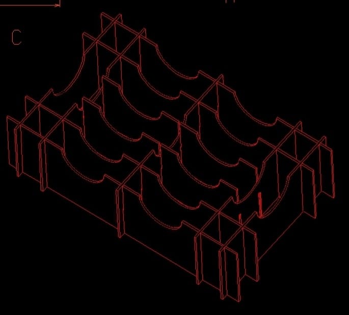

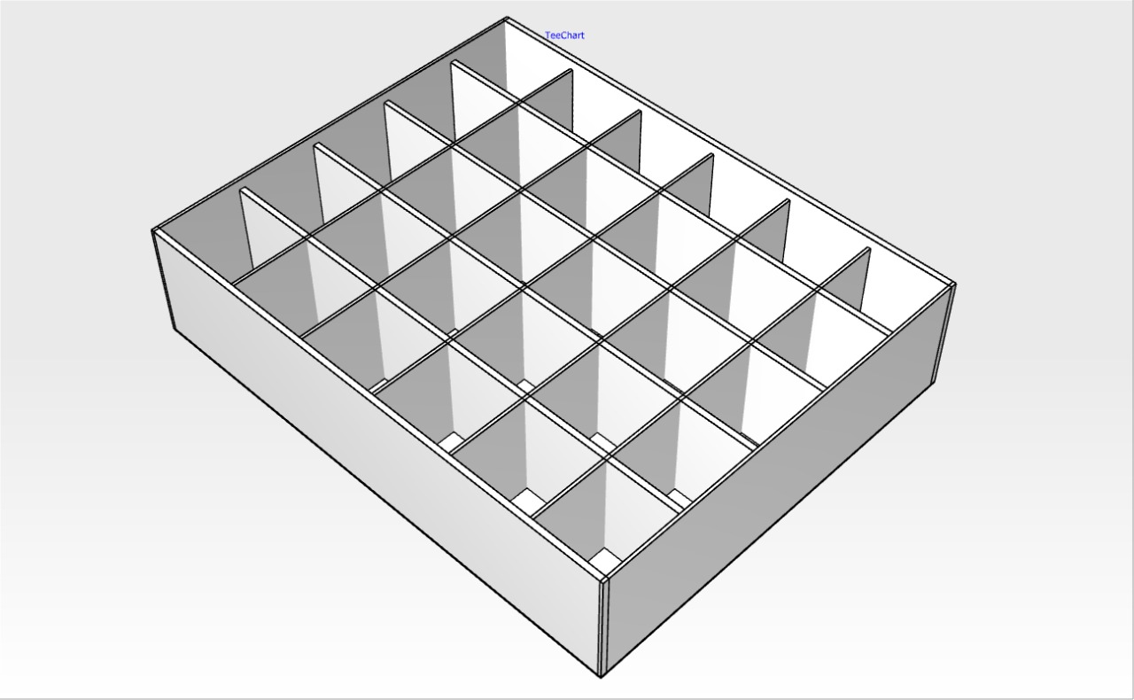

Hi!
I want to draw 3D objetcts like the picture number one. It has to have opaque flat walls and sections of the upper wall of every wall has to be cylindrical.
Till now, I managed to do several first downs but I'm still in my forties. I need to draw cylindrical surface opaque sections. My achievements are shown in picture number two.
Is there way to draw a cylindrical opaque section surface with axis parallel to the depth axis?
any hint ?
Thanks ...

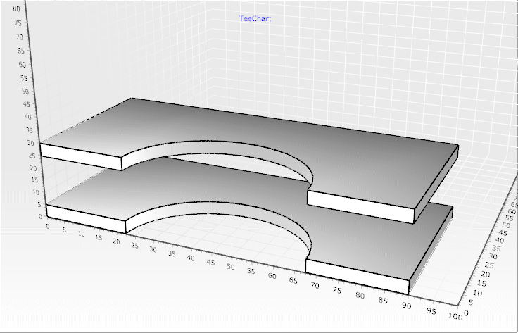

Post by Yeray » Thu Jun 03, 2021 5:43 pm
With Polygon3D (#2427) function you'll be able to get this:
Note that's still not a real arc. So it's done by drawing polygons side by side.
Option Explicit

QuijoteMx
Posts: 13
Joined: Wed Mar 24, 2021 12:00 am
Location: Mexico
Re: Is it posible to draw opaque cylinder surfaces in tchart.ocx
Post by QuijoteMx » Thu Jun 03, 2021 11:04 pm
Thanks for your response Yeray!
Both post are related. I'm just seen that there is a response in this thread: Is it posible to draw opaque cylinder surfaces in tchart.ocx.
The second post is about 3D flat polygons not parallel to cartesian planes.
For parallel 3D planes to cartesian, I'm using after_draw method of the tChart and the canvas methods of the series:
PolygonWithZ, RectangleWithZ, Plane3D and RectangleY, but what about tilted planes?
The cylindrical surface I'm trying to draw has its axis parallel to Depth axis (z coordinate). The code you attach produces cylindrical surfaces with axis colineal to left axis (y coordinates). I hope it can be modified to make it colinear to depth axis.
I hope you can give me a hint about how to draw 3D flat polygons not parallel to cartesian planes
Thanks ...
O. Molina
Post by Yeray » Tue Jun 08, 2021 10:45 am
It takes a bit of time to play with trigonometry, but this is what I understand you are trying to achieve:
