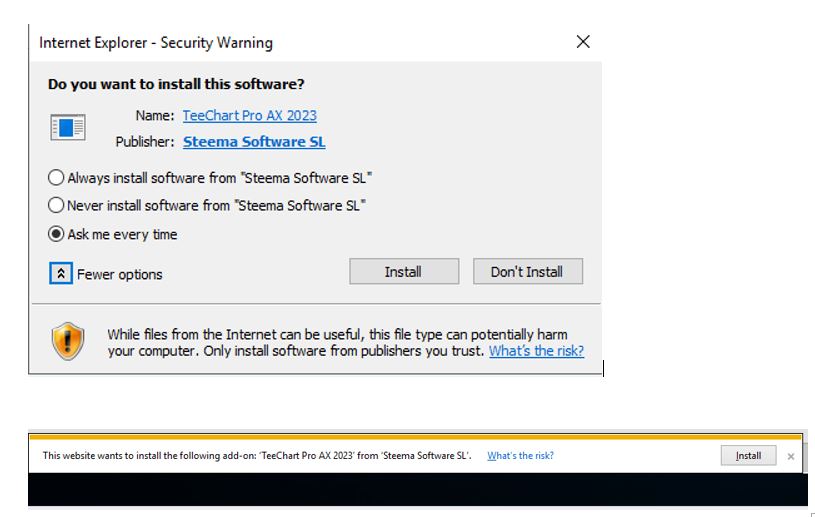

Hi Team,
I've taken latest TeeChart(TeeChart2023_0_2_23_ActiveX3264.exe) and used the TeeChart202364.cab file in my web application.
While accessing my application TeeChart202364.cab files are not installing on edge browser,Enabled activeX controls and trusted site with internet options from edge browser,But still i couldn't find installing cabinet file on the client machine.
Can you please look into it and let me know if you are able to install and execute TeeChart202364.cab files?
Thanks!

Re: TeeChart .cab files are not installing and executing
Attached screenshot of .cab files not installing
we've been reviewing the problem and as fas as we know only internet explorer is giving support to install activex controls.
We've not been able to make it work with the latest Edge version.
Hello Srikanth,
thanks for all the explanation. Now I've been able to reproduce the problem here.
For the moment still not found what is the cause that makes to not work the latest version and only in the 64bit version.
We continue looking at it. Will back to you asap (hope) with a solution.
