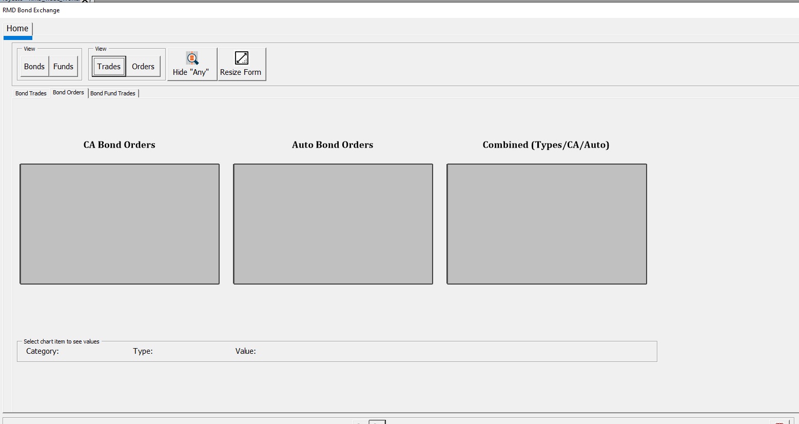

I've been trying to run the example you attached. In order to make it compilable and run I've had to comment and remove the lot of code, maybe more than enough.
At the end, as you can see in the image I've been able to run, but I can't see the Start button you comment to hit at the Home tab. Please, see the image.
If possible, it would be very good, in order to test and find a solution, if you can create a simple project were only se a Chart component and change size there by using button or similar. In order to try to find where the problem is and to go faster I think it would be the better option.
