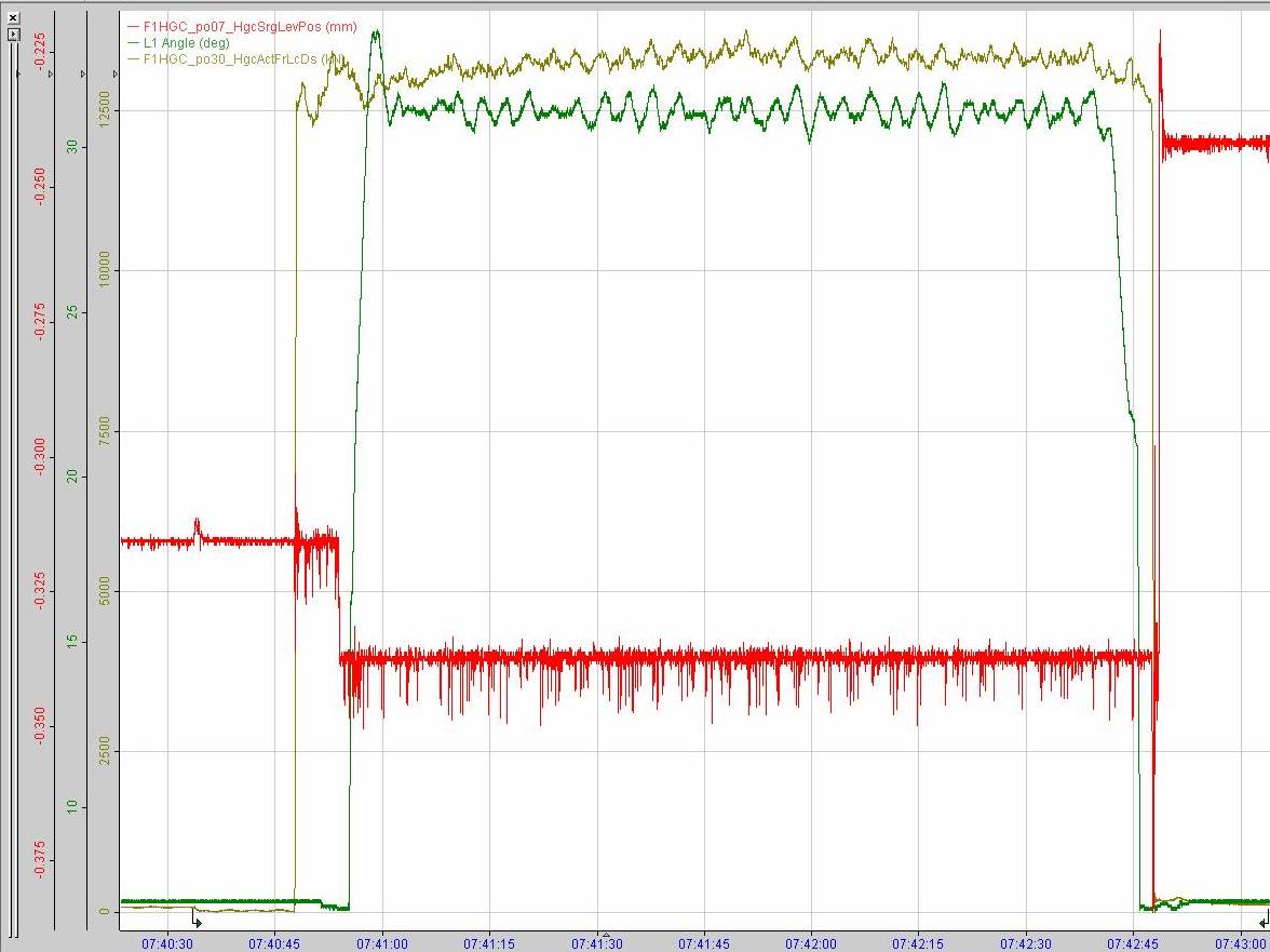

Hi! I'm developing an application using your example of multiple axis as model. I was doing so fine up to now.
The graphs should look like the one in the attachment.
The problem with zooming is as follows: If you zoom any section in the graph, x axis is zoomed but
y axis do not respond to zoom.
I think I should do that by code, but mousedown and mouseup event do not fire when I zoom in the
graph.
I've attached a simplified version of the code. Hope some one could help me.
O. Molina
