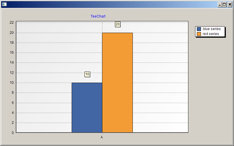

This is what I'm getting with your code:
I don't see what's wrong. I understand this is the result I'd expect with your code: Two side bars with one point each one. Their labels are "A" and "B" when you add the points, then you change them to "10" and "20". And you finally use custom labels in the bottom axis to just show a "A" at the 0.
Could you please explain again what result would you expect?
