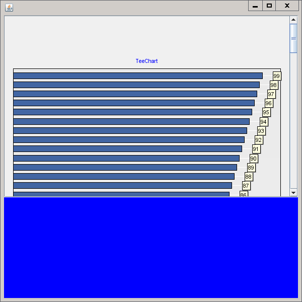

Post by Yeray » Fri May 09, 2014 2:00 pm
Hi Gustavo,
Are you using TeeChart Java v3.2013.1219?
I've pasted your exact code in a NetBeans project and this how it looks for me here:

Re: TeeChart with JScrollViewer
Post by Yeray » Mon May 12, 2014 8:26 am
Hi Gustavo,
First of all I'd suggest you to download the latest evaluation version available and try to confirm this is fixed with it.
If you confirm it, then you can update your registered version, or, if you own the sources, try to apply the change that fixes the issue yourself.
