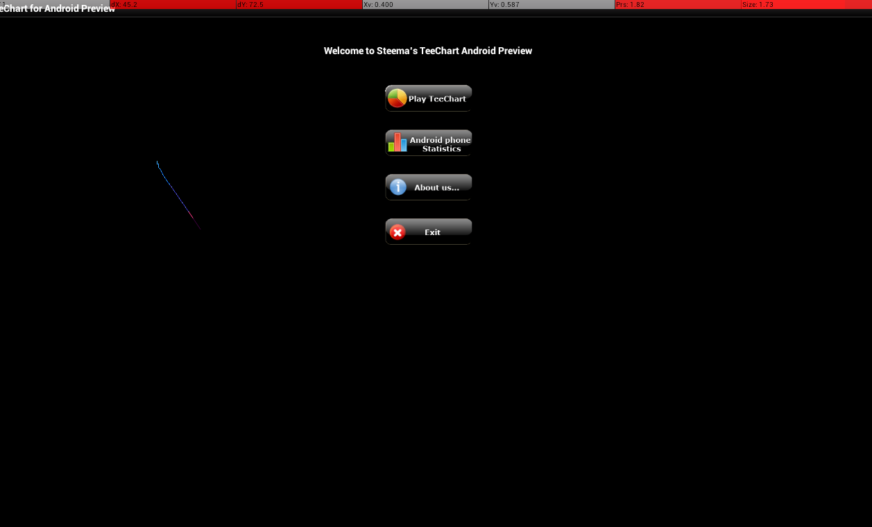

Here is the same motion but outside the chart (no error).
- HistoryPosOutOfRange5.png (31.65 KiB) Viewed 15402 times

I'm not sure if this application indicates what I understand but It looks like you are just doing the following actions, I'm not sure about the order:
- OutOfRange.png: drawing a little zoom rectangle from top-left to bottom-right, inside the chart. If you stop touching the screen after doing this action, you should zoom in.
- OutOfRange2.png: drawing a little zoom rectangle from top-right to bottom-left, inside the chart. If you stop touching the screen after doing this action, you should unzoom.
- OutOfRange3.png: drawing a little zoom rectangle from bottom-right to top-left, inside the chart. If you stop touching the screen after doing this action, you should unzoom.
- OutOfRange4.png: drawing a little zoom rectangle from top-left to bottom-right, out of any chart. It should do nothing.
Are all these gestures correctly interpreted?
Are all them giving you errors?
Is the error message you are reporting the "TeeChart for Android Preview is gestopt" one we can see in the screenshots?

Hello
You are right about the pictures.
The gesture of the picture happend when i press one finger against the screen.
The error message is indeed the historypos out of range error.
Sorry for the confusion
