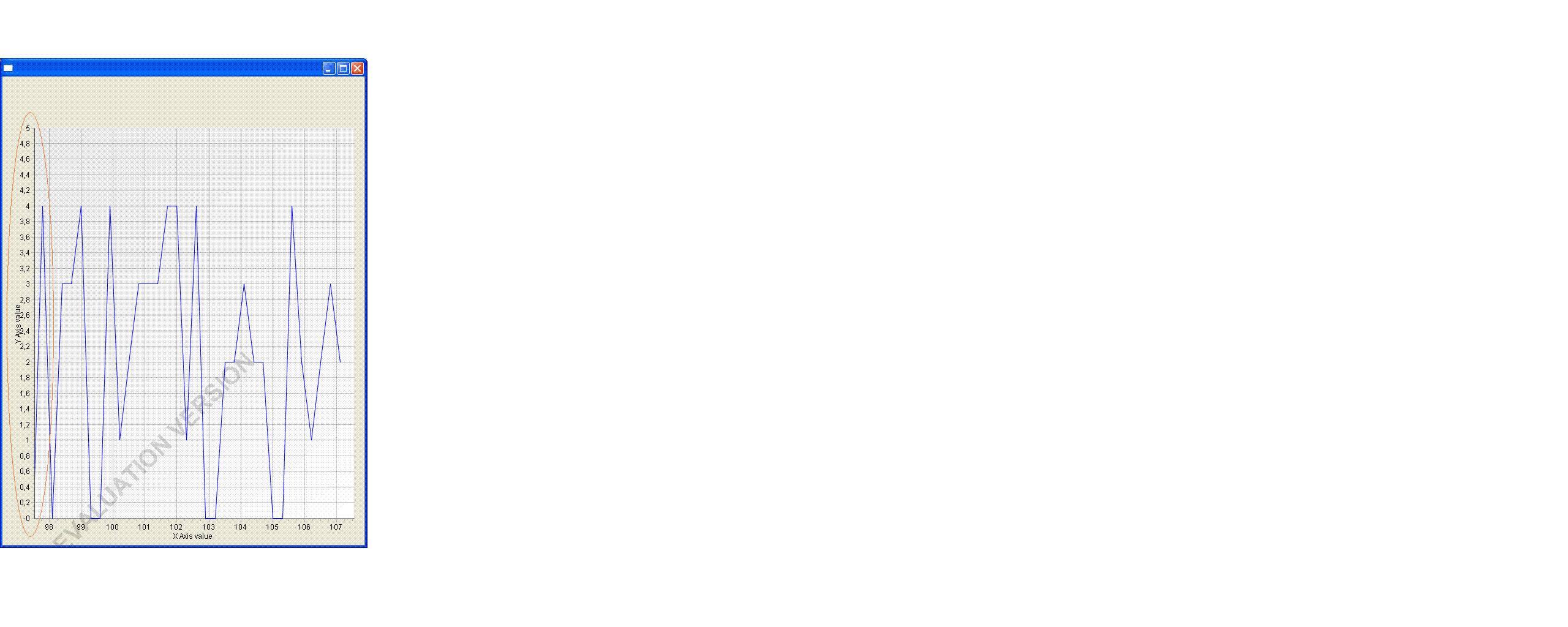

I had a problem Left Axis.Left Axis title and Lables are overlapping some times.
suppose Yaxis min & max values are intger values ( like min 0 Max 5).please have look at attached file.
I have gone through code I found a problem in maxLabelsValueWidth() in Axis.java.
In Above method only min & Max values are considered for defining LabelWidth,in between decimal values are coming ,then those are not considered.
please suggest some solution.
Advance thanks for your support.
